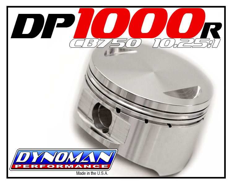

Maybe this will help.....
When I ordered my 71.25mm JE pistons from Dynoman to fit my 24.4cc chambers (K6 head with opened chambers for old style RC836), I got the answer from Buzz that CR number is based on 22.5cc chambers (except for the F2 pistons).
I asked for CR10.5 with 24.4cc chambers.
My pistons look like DP1000 CR12.5 that is slightly machined on top. See photo below.
Photo with piston at TDC, JMR billet block, Base gasket used is RCS .020"
Dynoman DP1000 CR12.5: http://www.dynoman.net/images/engine/piston/dp1000-71r/DP1000-71r.jpg
Dynoman DP1000 10.25: http://www.dynoman.net/images/engine/piston/dp1000r/DP-1000r.jpg
DP1000 CR 10.25 is 185g, CR12.5 version 195g, mine are 190g.
I do not know the final result of CR, bike runs good, no pinging. Head gasket is the thicker MLS gasket, .040".
I'm sure that the thinner base gasket .010" and head gasket .030" will not hurt my build.
Cam is DP315 with rather much overlap that need more CR.
I'm sure it will run OK with another cam with less overlap as a Megacycle 125-75. Higher compression might crank up the temperature as well.
