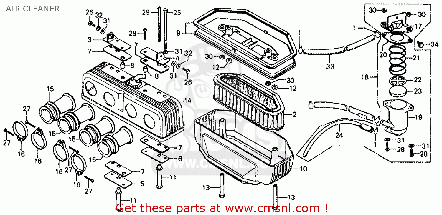

Crank case vent should be routed to oil tank via the breather assy, right?
Some parts must be missing here, not only the air box
https://www.cmsnl.com/cb750f-750-super-sport-1976-usa_model490/breather-assy_17260392000/#.Wx14DYr7TIV
https://images.cmsnl.com/img/partslists/honda-cb750f-750-super-sport-1976-usa-air-cleaner_bighu0050f2015_bcd6.gif
If you route rear breather from engine direct to oil tank, over pressure will occur. That,s why you need the breather assy that vent it out, but back in to the engine via air box as an environmental thing. No air box, still need of the ventilation between engine rear outlet and oil tank.

The breather assembly is still there, but the air box doesn't have the fitting on top to connect to the breather assembly.

Do you have a schematic or a picture of how that should be connected? The images PeWe linked are not exactly clear on how the hoses connect.
