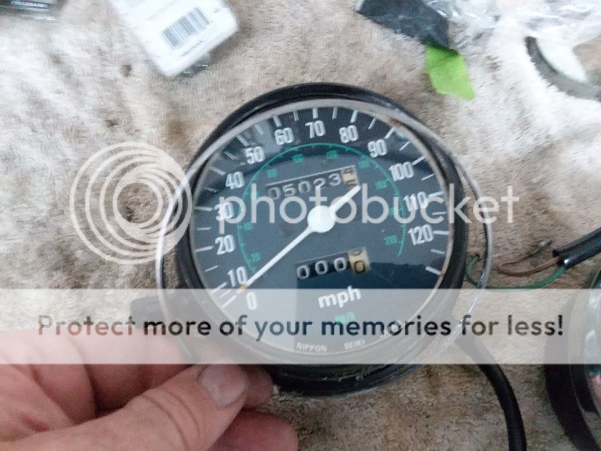

 How are you guys attaching this chrome trim ring?
 It was loose at the end and I tried some 2 part epoxy. Then the whole damn thing came off! Super glue?

Thats because it is supposed to be in one piece, now its been cut the only thing you can do is glue it on.

Doubt it, the only thing i know that sticks and then only temporary is fingers. I would use epoxy all the way round and hold it in with a big jubilee clip. In UK i would use araldite

With the ring being cut and pretty mangled I would buy a new ring.  You can order one here:  https://www.cb750faces.com/cb750faces.nl/
If you want to salvage the old one I would try and get it bent back into some usable shape and then use JB weld and hold it in place with a large hose clamp being careful not to have the epoxy ooze onto the clamp.  Once it sets you will never be able to open it again so make sure everything inside is working.
The best way to open the gages is to use a old fashion pain can opener.  It's the best way I have found to bend up the underside (backside) of the crimp ring.  The hardest part is re-bending the ring back again to close up the halves.  I just rebuilt my gages for my GL1000.

Those rings are very hard to close. I have tried, gave up when lacking proper tooling pressing the ring tight.
I could not find a clamp thick and rigid enough to have around the gauges with ring on and squeeze it together with screwdriver

 I used some JB Weld. It ain't the prettiest, but the repair/gap is at the bottom and shouldn't be too noticeable.
