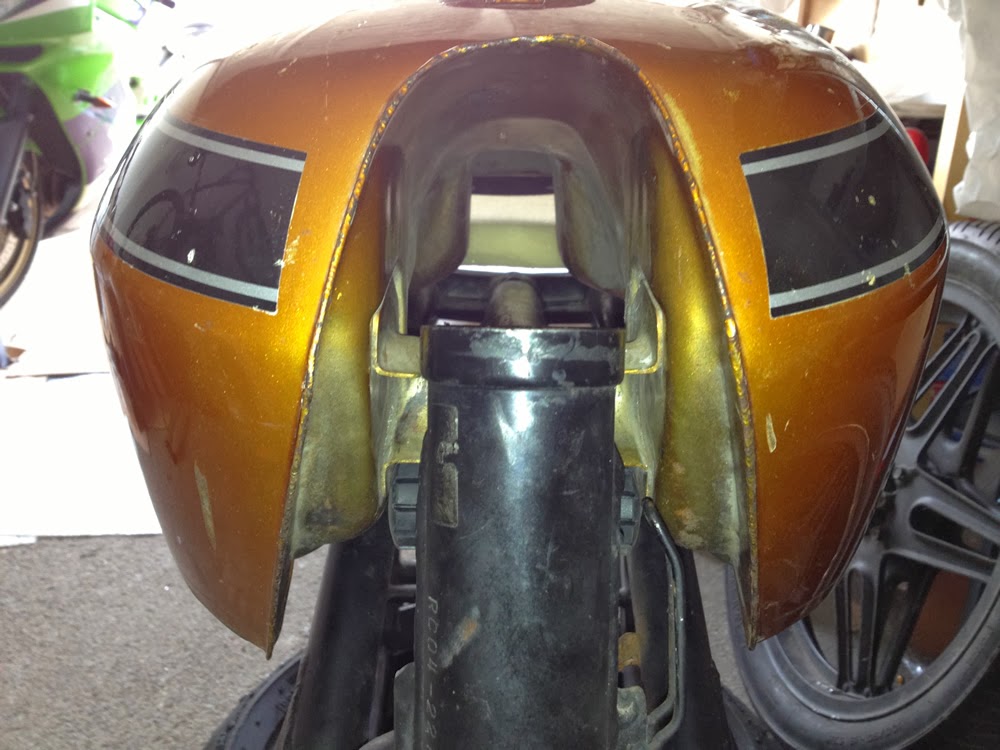

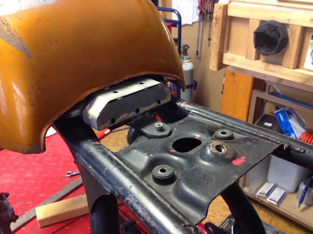

Basically the inside of the tank needs widening in the areas where it hits the frame:
It is not actually that much it needs, about 2cm (1 cm either side) would be sufficient.
It also needs bringing back a couple of cm so that the bars don't hit the tank of full lock, therefore ill somehow have to move the mounts for the fram rubbers back a couple of cm:

I basically had two options that I could do with the tank (which is good as I have two tanks to play with :) ). The first / easiest option is to beat the indies in the correct places until the tank fits (not the most elegant solution I agree). The second option is to cut out the sections of tank that hit the frame, and that fill / cover and weld the cut areas with shaped metal to fit accordingly.
To get the ball rolling, I took the first tank and first solution so I could see if once the tank is fitted if all my other ideas related to the tank (seat, bars, riding position etc...) would work, at least this way I had and working base ad something to start with. Its it all works out well, I will complete the tank properly by cutting and welding the underside to fit properly (watch this space).
I filled the tank to the brim with water to prevent damaging the tank when beating it with a rubber mallet - this did not work as I created extra dents in the tank, and cracked the inside of the tank :( although this is not the end of the world as I can weld up the cracks and the tank was already dented and in need of some TLC (just needs more now).
I also had to babysit while doing this:
I have now beat the top inserts into shape (red) and will now move onto beating down the blue bits.
Finished, the tank now sits nicely on the frame with no rubbing or contact to the frame, it just does not look very nice, is dented and cracked :(

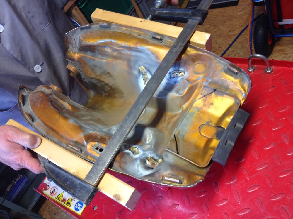

I found a guy in the town I live who has a Kawasaki Zephyr Club and small workshop that he has very kindly said I can use for my project. He is very interested in the project and is willing to help out :)
I took the tank down to try and fix what I had broken while beating it into shape.
First up was to repair the cracks in the bottom of the tank:

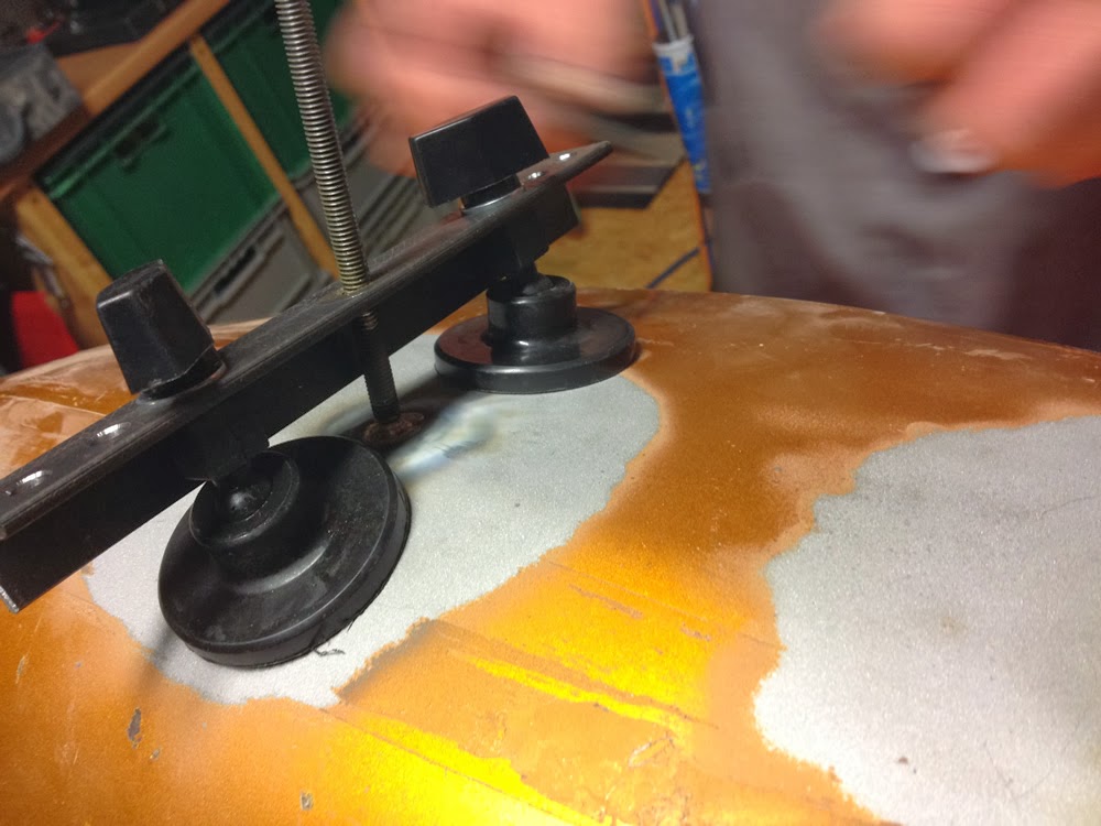

Once ready, we tried to pull out the dents using an adhesive based puller:
This sadly did not work dues to the strength of the metal used for this tank - as I d=found out while beating the tank, these old CB tanks are solid !!! a lot more robust than other tanks !!!
I therefore had to weld rods to the tank and pull the dents out this way. Although messy, this worked well ! - Pictures to follow.

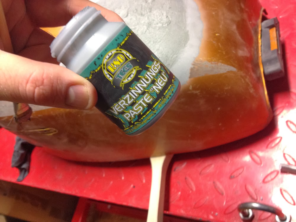

Hi I used a special tinning solution that containing lead. Here is the exact product that I used:
http://www.korrosionsschutz-depot.de/shop_xtc/product_info.php?info=p419_Karosseriezinn-25-ig--Stange.html
I applied it using a non corrosive zinc chloride based paste and a v-hot flame :)
http://www.korrosionsschutz-depot.de/shop_xtc/product_info.php?info=p421_Verzinnungspaste-NEU-nicht-korrosiv--250g.html

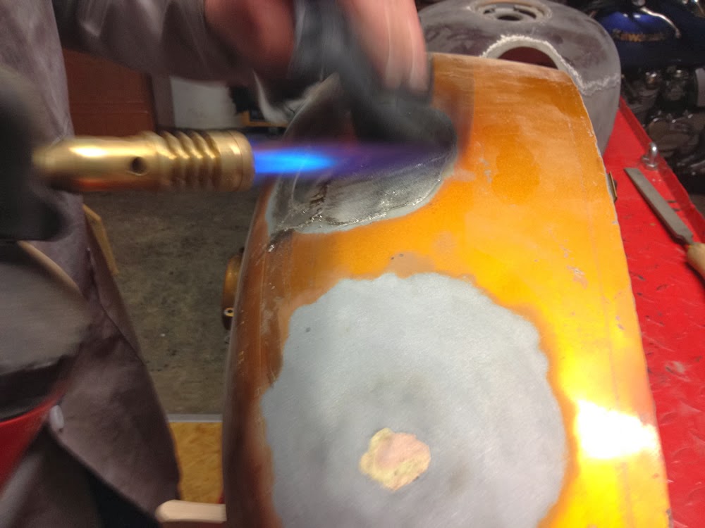

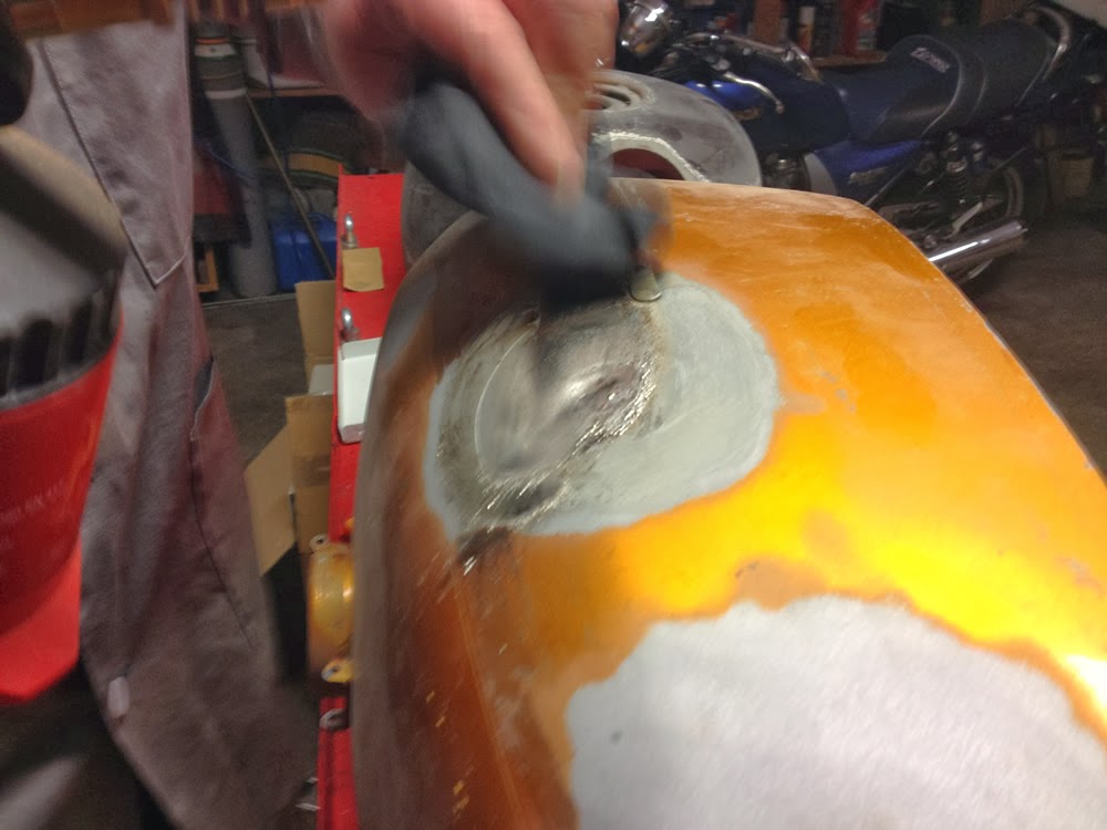

As I mentioned and showed in a previous post, I used metal rods to fill the wholes instead of using filler etc.. mainly just to test and try the method in comparison to filler as I have heard good thongs about it and also as its a stronger finish etc. The rods are basically a tinning solution that contained and when heated up melt into a fluid solution that can be worked with. Since my last post I have however improved the process. I was experiencing problems on some parts of the tank where the solution was not mating well with then tank (although blasted and cleaned). I looked further into this and bought a non corrosive zinc chloride based paste which I applied to the tank before filling with the rods creating a v-good bond between the two:
Its really easy and good, basically apply the paste:
Heat it up:
And wipe it off:
Leaving a perfect surface where the lead filler can be nicely applied to
This is all cool and much fun, although the next step is basically sanding, sanding and more sanding which is not much fun : ( Here is a small one I completed as an example:

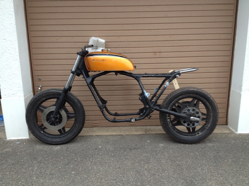

Needed a break from dents so decided to finally get the SOHC tank fitted and sitting how I want it on the DOHC frame. Started out with the original tank to get an idea of spacing and how much room there is to play with re the motor etc...
Also added the yokes and bars to make sure they do not hit the tank on full lock - this was a worry of mine as I thought they would, and id have to modify the rubber mounts to move the tank back a couple of cm however they do not and there is full clearance on both sides :)
Further modification required - the tank still needs to sit a few cm lower at the back and the tank bracket holder catches on frame in the corner, so they needed to be trimmed:
Once trimmed the tank sat lower which is good, but bade contact again from other parts underneath, therefore further heating and modification was required :S
After a few hours the tank is sitting at the required / wanted height and is making no contact with the frame :) result ! However all the modification has appeared to dis-shaped the tank a bit - it is now wider that before. We simply compressed it a cm and its back and square again:
This is quite a step for me... from the start I wanted to use the older tank on the newer frame and now this step is almost complete. The tank is sitting how I want it :
I have learnt a lot getting to fit this tank, and know that next time I will do it differently :) The better way would have been to simply cut away the problematic areas and weld them back with sheet metal etc rather than heating up the underside of the tank and modifying it with a hammer :) however you live and learn and this is the whole point of this project !

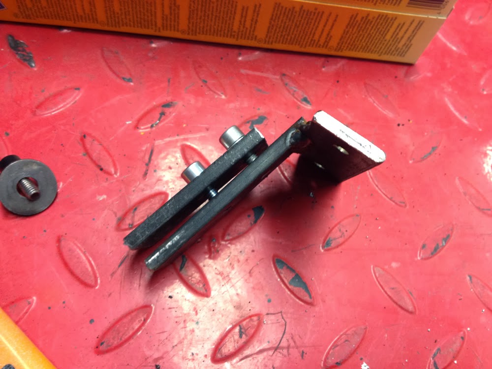

I decided to make a bracket to allow mw to work on my tank (sane and paint) on the paint frame to basically give me better access and angles to the tank during sanding etc ...
Front bracket:
Back bracket:
Finished:
