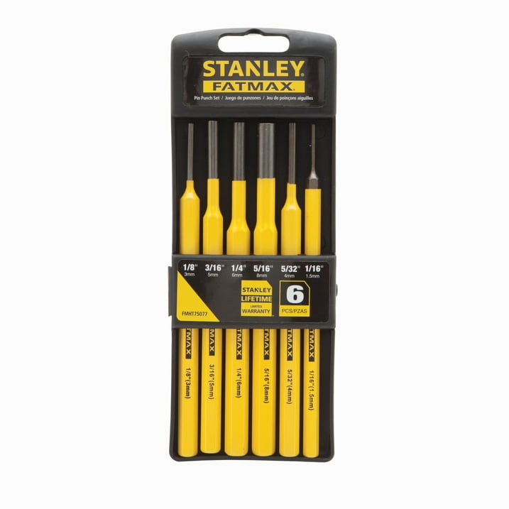

Tried to use a c-clamp and a 6 penny nail to push the cap pin through, but the nail just bent , also need another pairs of hands to help hold.
I do not remember the dia of that pin but Mao mart has a set of Stanley pin punches that work well and are cheap enough($20) to just toss and buy a new set once they get a little messed up.

Drill off the “head” and push it through. The other end has been punched and can be swollen enough that it’s best to reverse it out.
