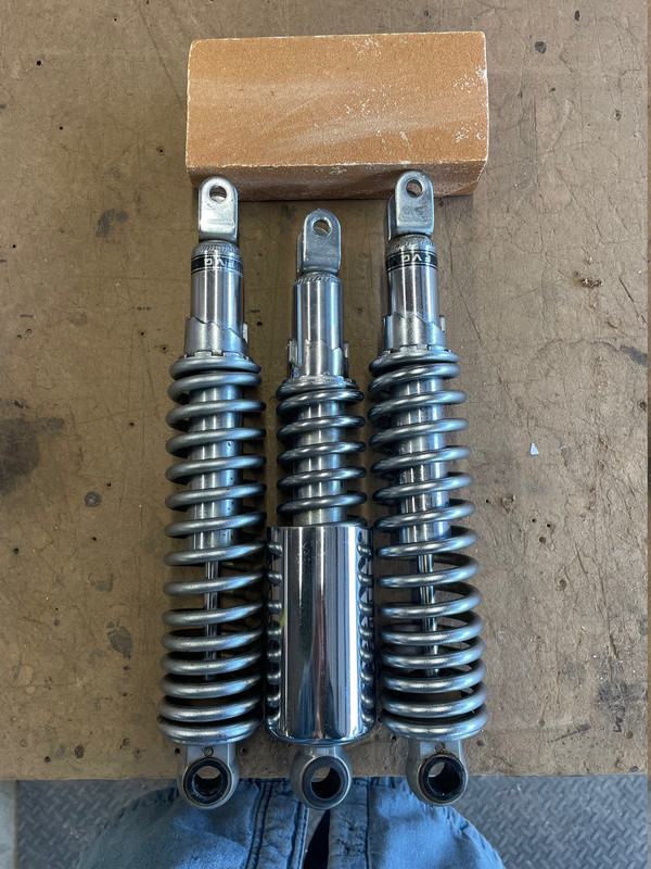

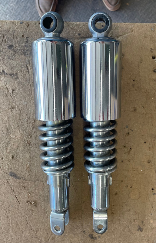

Ordered a pair of low-mileage shocks off a '75 CB550F which are reportedly 5/8" shorter than the stock CB650 shocks, eye-to eye. These have an upper shroud which may cause fitment issues. I will attach a photo and description.
My reasons behind this choice are complicated, but include:
I felt OEM shocks would be better quality than the cheap imports now available.
I felt that shortening the shock length by only 5/8" would have less negative affect on handling and ride than the much shorter "bobber" shocks currently available.
Budget (a little over $100 delivered).
The provenance and apparent condition of these are appealing.

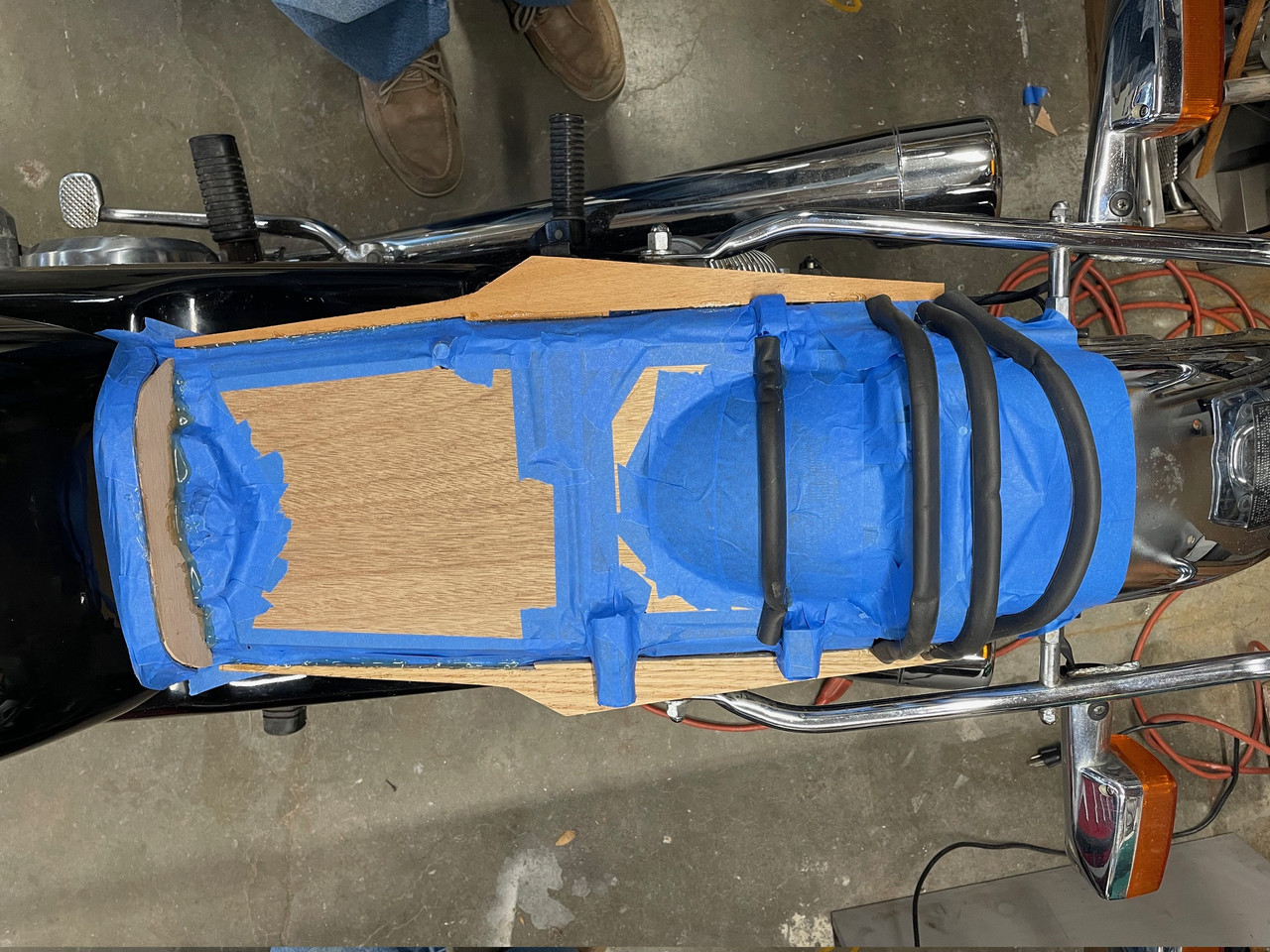

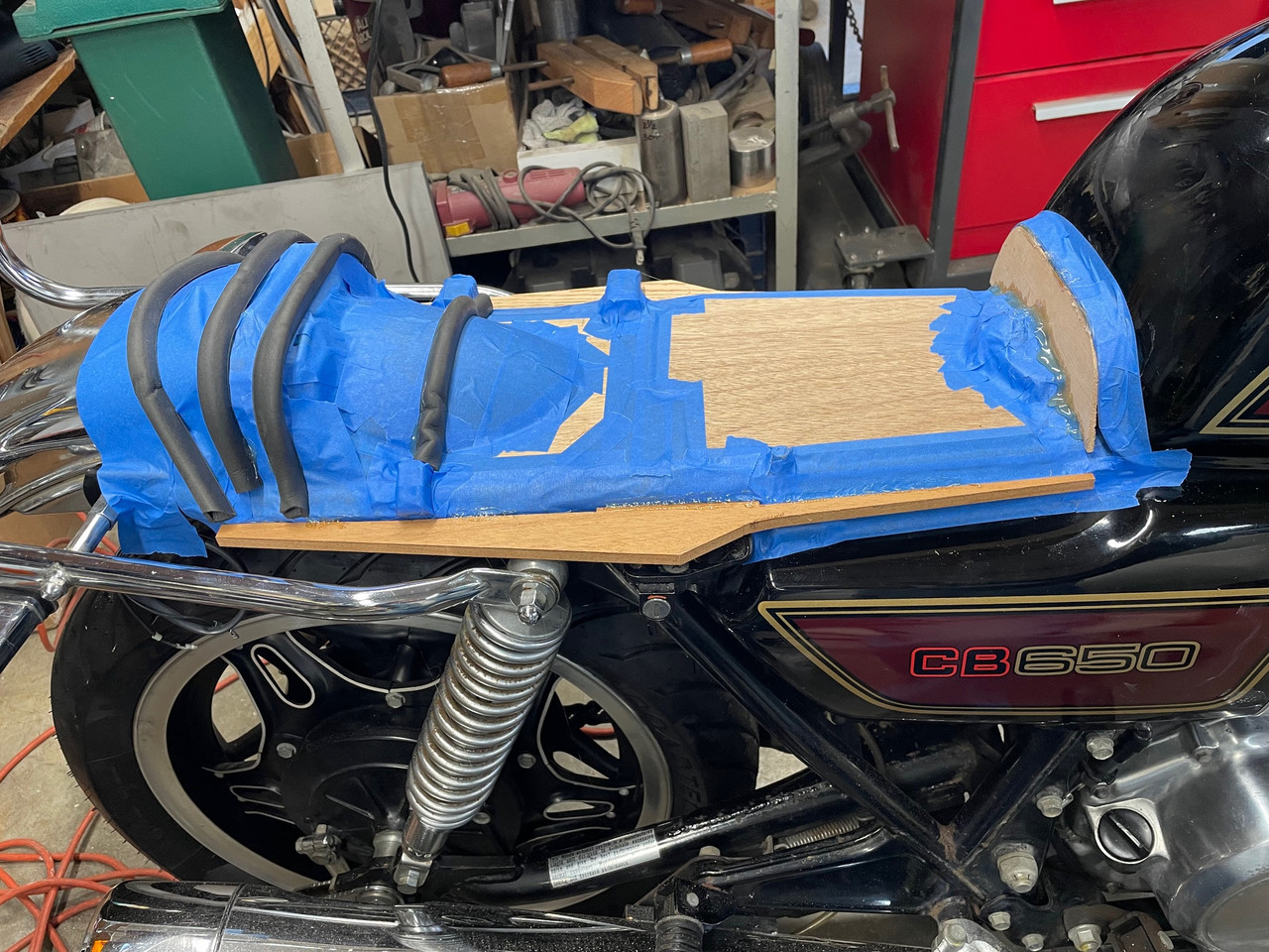

Scoped out the seat modification parameters this afternoon.
Photos show my use of tempered hardboard to make a rough template of the existing seat profile, referencing off the fuel fill cover and rear grab rail. This shows that there is a space of about 4-1/4" between the existing seat outer surface and the nearest hard parts of the bike (frame, inner fender, etc). Even if I allow a nominal 2" for foam padding, this means that I could potentially lower the seat profile by close to 2"! Surely I can rationalize this as an extremely worthwhile project.
My initial concept is to fabricate a custom solo seat pan using primarily epoxy and biaxial cloth (which I already have). Then mockup a hand-formed foam pad (so I can optimize the fit to myself) and hand that over to a local auto upholsterer I know who has previously done excellent work for me on leather seats. Perhaps I'll sleep on this idea for a couple days to be sure it's the right approach. All comments welcome.
If this forum is deemed inappropriate for showing this customizing, perhaps the mods will notify me or help relocate my thread.

Partly to aid visualization, and after masking to protect the existing finish, I made a little preliminary progress on mocking up a new solo seat pan mold, using some bits of wood, foam rubber and hot glue. To begin I removed the pop rivets attaching the metal holder for the owners manual; slightly rerouted the wiring for the tail and license plate light, so the bulk of that will be hidden under the pan; and set aside the existing seat hinge to lower the interference points. The foam gasket material establishes the minimum space under the aft portion of the pan and also the aft outline of the pan, which just covers the wiring where it comes up through the grommet in the fender.
This is a work in progress to be advanced in my spare time.

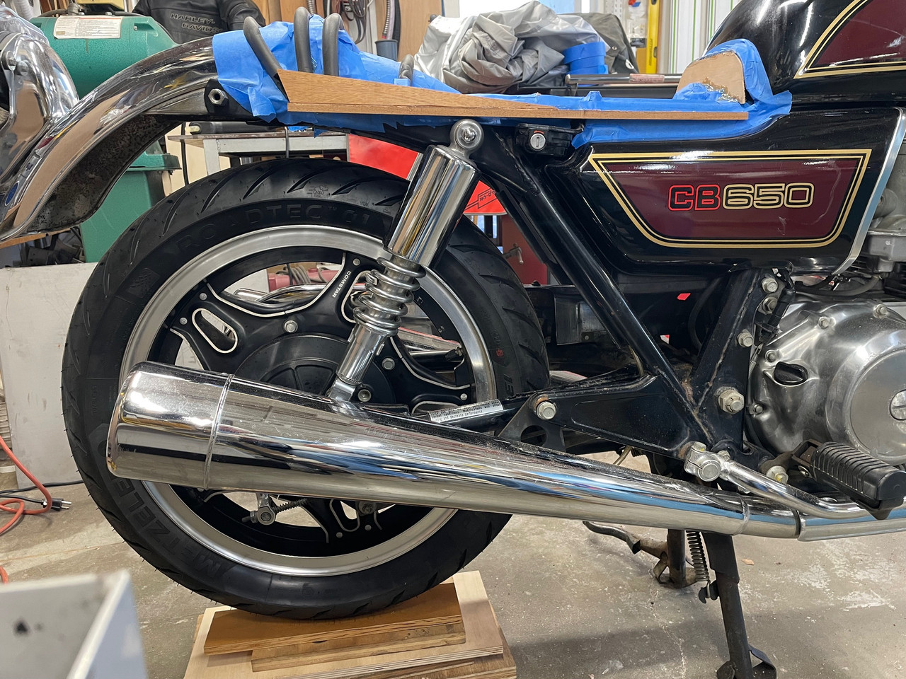

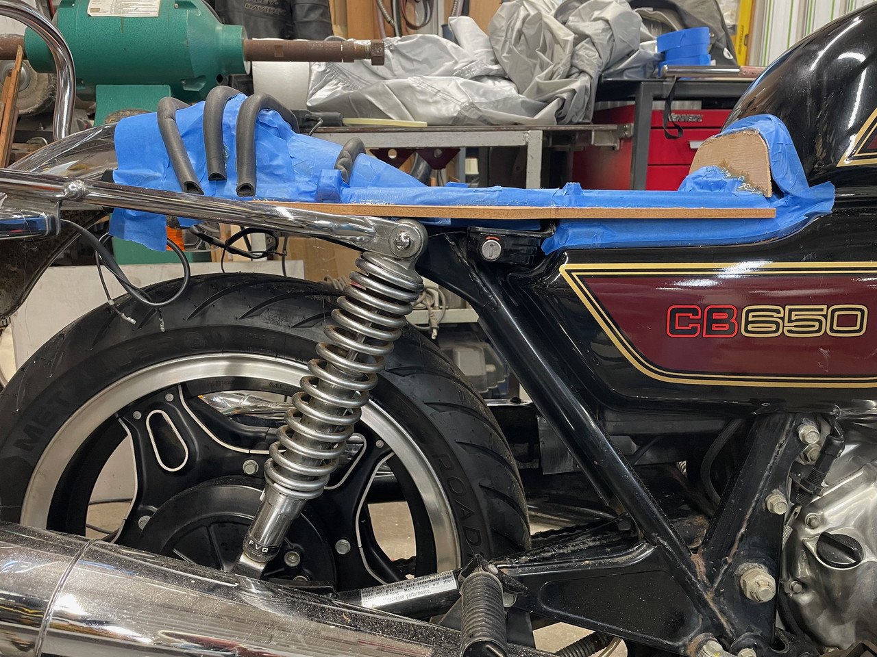

The "new" shocks came in today, so I installed them. With the bike on the center-stand, the distance from the floor to the bottom of the tire increased more than 1"! Not sure what that translates to in lowering the stand-over height, but I am very pleased with the apparent result.
These shocks are in extremely nice cosmetic condition. The spring wire diameter and coil diameter are slightly smaller than the
originals. Here's hoping they will be stiff enough. The pair weighs nearly 1/2-pound less than originals. Since it was necessary to remove the handrail, for now I'll leave it off to facilitate fabricating the seat pan. Also removed the passenger pegs.
