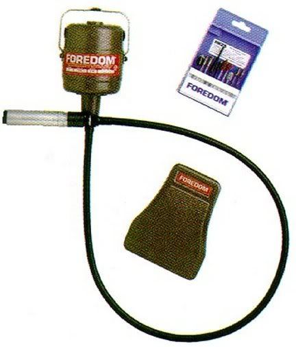

Do the abrasive "drums" clog up with aluminum? I grind aluminum bases for my Suzuki oil cooler adapters with a belt linisher and 7 inch disc mounted on a pedestal grinder, and I have to use a "dry lube" stick to stop the abrasive from clogging up with aluminum particles, is that a problem with the grinding drums on an air grinder too? ;D
Offline MRieck
  • Posts: 10,792
Re: porting: spare heads wanted
« Reply #28 on: January 03, 2008, 05:37:59 PM »
If you spin the burr to fast it will heat the suface of the aluminum and surface harden it. It will create ripples which can be a PITA to remove. I use a Foredom electric unit with variable speed foot control. It's quiet, has a lot of torque and offers great control.
  • Posts: 33,599
« Reply #29 on: January 03, 2008, 06:08:47 PM »
Is this the one Mike? Looks good! ;D
Offline MRieck
  • Posts: 10,792
« Reply #30 on: January 03, 2008, 06:15:20 PM »
Bingo Terry.
