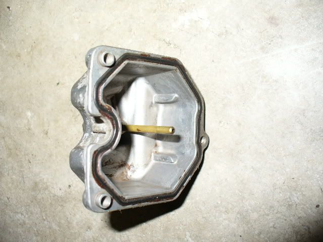

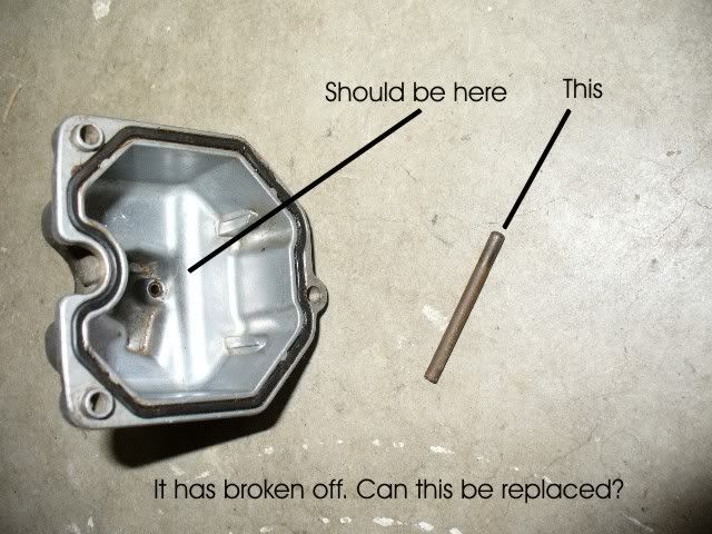

Help!!! While cleaning the carburetors from my 78 CB750 F2 the bit that should look like this below:
Now looks like this:
It broke off.  :'( :'( I think it was corroded. Thats my story anyway. Is there any way this tube can be removed and replaced? Or can I just leave the bottom in and don't bleed the float bowl ever again?

In theory, you could drill out the remains, find a hobby shop that sells brass tubing of an appropriate size, solder up one end, drill a hole the same size as the old one in the end, and then press it into place to repair the old bowl.
But, it may be easier to get a replacement bowl.
Anyway, you need to have that stand pipe in place or fuel will stream out the bottom.  The drain screw does NOT block that tube on these carbs!

That's not for bleeding, that's the overflow tube.  You might be able to get away with some JB weld but I don't know if it's suitable for gas submersion.  What ever you do, don't just plug it.  There are stories around here of overflow tubes being clogged and a bad float valve letting fuel fill up the bowl.  With no where to go it just fills up the intake and works its way into the case.
You should be able to find another bowl relatively easily.  As to the corroded state, stick to your story ;D

Thanks guys. I thought that may be the case. As you say it's probably easier to get another bowl. I just hope all the others don't go the same way. Bloody clumsy.Cheers

That tube must be in 2 parts because the drain screw goes right through where the tube should be. So if I drilled out the top bit thats left in and do what TT suggests then it should work?? If so what would you suggest to use as a "glue"or should it just be press fitted with a sealer?

Might try screwing the appropriate size sheet metal screw in there and pulling it out with pliers.

No problem mate. I drilled out the broken stem and got some brass tubing from the hobby shop. It was a slightly smaller dia so I "Tinned" the tube with solder and pressed it in. I also soldered up the hole then redrilled a smaller one. I filled it with petrol and left it for a day sitting on white paper. No leaks so hopefully that will work. Fingers crossed.
