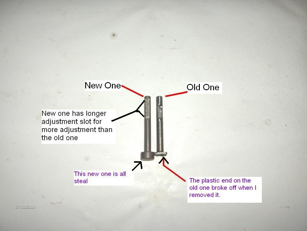

I have looked through the FAQs and haven seen anything related.
I was going through my parts and found that the tensioner push rod the one that actually has the springs around it HAD a rubber piece bonded to it and is no longer bonded, honda doesn have this part anymore and was wondering if anyone had an alternative? or do I need to search for a used one?
I have just been through this on my 350F  :D
The replacement part is an upgraded design.... might have to search for one, I got mine from westernhillshondayamaha.com had one for about $25. Had it in their old stock. local dealer says it's discontinued:
 Matt.

Re: 400 f tensioner question
« Reply #6 on: March 28, 2008, 06:37:52 PM »
Here's the part #
1974 CB350F is:
BAR
14550-369-020  (replaces 14550-369-010)
The 400F part # is different, so see if you can get the right one for your machine first, and if not, see if you can get this one. I'm pretty sure they're the same part.
Just go through the parts finder at their website to get the numbers:
http://www.westernhillshondayamaha.com/fiche_select.asp
That plastic piece you're talking about BBIN only came off on mine after I took it apart. I had to remove the adjustment bolt that had been broken off by the PO and it got broken in the process. I would'nt try gluing it it you can find one. If it comes apart later it's not easy to get at which you already know  ;)
 Matt.

...you beat me  :P
1977 400F is:
BAR
14550-333-000
...there's gonna be a race to find these things. Glad I already have mine  ;D

Did a bit of digging around and found out that part # 14550-369-020 is a CB360 part. now I do know the 360 uses the same tensioner set up as the 350/400F. plus I see it was superceded from 369-000 and 369-010.
Plus the 369-020 is listed as a superceded part for the 350F but not for the 400F. It still lists the 333 # for the 400F, now which part came first?
What year did the CB360 come out?
I have a 350F motor and various 400F motors here and that part for both motors is identical.

Quote:  "IIRC, the shorter one on the right was the ones used in the retrofitted tensioner's bodies. The longer one on the left came out the following year, when a fully redesigned tensioner with adjusting bolt was fitted to the second model year of the bike. I think that's the same ones that ended up on the 400F, but I didn't work on enough of those to remember...  ".
Question:  does it mean that to do a proper job, not only I would have to buy p/n 14550-369-020 (Bar), but also the "Fully redesigned tensioner with adjusting bolt"

You only have to find the push bar. no other parts need to be changed as the lock bolt and tensioner horseshoe shaped bracket are the same on all models. nothing changed in the design.
