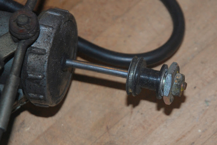

I've heard sync'ing the carbs can be a challenge. Does removing and cleaning them require you to sync them upon re-install? Or
KBC
KBC
Sorry, but yes.

I've heard that syncing them requires a special tool...or is there a trick of the trade to sync them relatively easy?
As trick as it gets
http://www.carbtune.com/
You would bench sync them prior to installing them - then fine tune that with a carb sync.
To your first post, if you're running it doing all your diagnosis while its stationary its going to get really hot. Shouldn't run for more than 2 minutes sitting still in a garge. Put a floor fan on it per Johnie.
As to synchronizing, you can "bench sync " them without a tool. It may still run poorly but if you've fixed the problem a bad sync job isn't anything as bad as you're describing. I'd say the carbs have to come off. Or heavy doses of SeaFoam and carb cleaner thru the fuel and crossed fingers.

Thanks again all.
KBC
It depends on how far you broke them down.  If you took off or loosened the adjuster nut on the top, then yes... otherwise you don't need to (at least because of your cleaning).  The adjustment that the carb syncing addresses is the below adjuster nut.  If you haven't loosened these and you haven't lost track of which one came from which carb, your carbs will be synced about as well as they were before you took the carbs apart.
