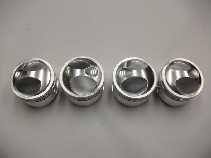

there you go
66'ers
17 is edge of pin hole to piston edge
would be 24,5 pin CL to edge
crown curve goes almost edge to edge.

These look perfect for the RC181 project. PM me price details, please.  :D

They are yours and there's no secret price paul, you'll only have to serve as my posting address to get me stuff from the USA for the next few years..... a deal?
and still, would check ebay before shipping across them ocean,

1972 NORTON Commando Combat

Offline 65Ch3v3LL3
  • Posts: 195
Re: 550/650 hybrid or 650 big bore HOW TO
« Reply #171 on: September 12, 2011, 02:27:47 AM »
Paul,
If I remember correctly I think I read that Soos recommended the 77-78 F2 pistons so the CR didn't drop so much. Do you think the Cycle-X domed F2 836 pistons would work in the 650 chamber?

Offline paulages
  • Posts: 3,876
  • 1976 cb735
    • DOOMTOWN RIDERS P.R.M.C.
« Reply #172 on: September 12, 2011, 10:14:55 AM »
They look like they'd work well, still needing some machining of course.

Offline 65Ch3v3LL3
  • Posts: 195
« Reply #173 on: September 12, 2011, 10:37:25 AM »
Thanks Paul. Yeah I knew I would still need to machine the edges for the smaller combustion chamber I was mostly concerned if these had too much of a dome to fit in the chamber. However the valve reliefs look really deep so I'm assuming there is plenty of material there in case I need to remove a bit.

Offline Pinhead
  • Posts: 1,818
  • 1979 CB652-ST
« Reply #174 on: September 12, 2011, 12:12:54 PM »
Personally I think those look like they'd produce too much compression.
The factory 9:1 '78 CB750 pistons produce 10.5:1 to 11:1 compression on a CB650.
Those look like they're at least 10.5:1 or higher on a '78 CB750 (which has a larger chamber) and would be quite a bit taller than the stock pistons.
