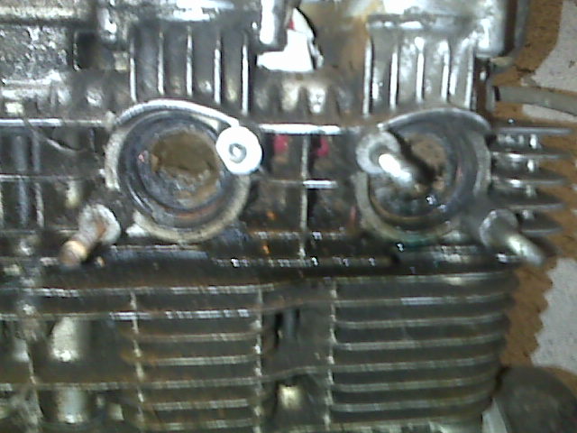

Here's some closeups of the head with nearly 1/4" of grime on it!
And the little o-rings, one on each side.
And the additional grossness once again of the ports:

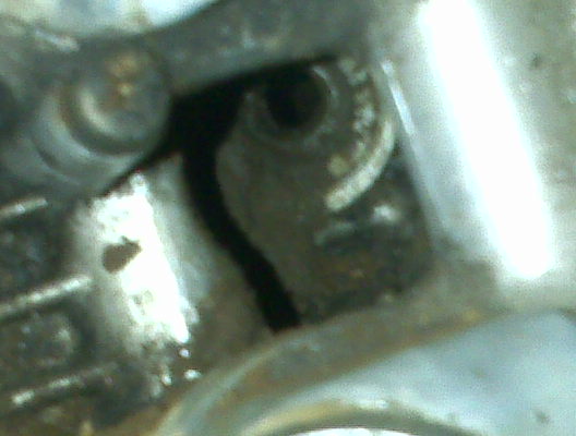

So my intake valve on #1 is bent from a knock on the cylinder when I was unsticking the b-hatch. The valve itself will NOT come out of the valve guide, and I feel like I'm just bludgeoning the sh!t out of it, even though I'm trying to be gentle.
Questions
I know there's a valve guide removal tool - should I even worry about taking those out?
Will a 550 head fit on a 500 direct swap? I'm looking at the price for a replacement valve on BikeBandit, and it's more than this ebay auction.

« Reply #19 on: November 05, 2008, 12:54:03 PM »
Questions
Valve guides can be replaced.
Normally, you heat up the head, then knock it out.
The new guide is installed, then it is reamed out with a precision reamer.
Do not attempt to use the new valve guide without doing that - they are not machined to give the proper fit without precision reaming.

« Reply #21 on: November 05, 2008, 05:19:03 PM »
Dagersh: I will look at that thread right after this post for sure! I do have the cam cover and it's in decent shape. MAn you've gotta lotta bikes! I'm slightly jealous. . .   ::)
tbpmusic: I wish I would've read your post about heating up the head first. I totally nailed the end of one when trying to "tap" it out. Luckily I have this on the way which should give me more than I need in the world of replacements. Next time I will heat it up! Would you recommend a torch or a hot lamp or a hot water bath? Here's my spare part farm. Has 9000 miles on it.
So to remove the bent valve, I grabbed my dremel:
And took to it!
Easy as pie! I love that thing.
I then used part of the tool I rented with my own c-clamp, thank god for that. Worked quite well.
Ugly Ugly goop.
Then into the bath to sit overnight. Unfortunately, I had to dilute the solution to totally submerge the part, 1 to 6. Hopefully it's not to weak! Pistons, Head, Valves and all.
I ordered a Honda Spark Plug Tool so I can actually get my D7EA's in and out, which is impossible with a regular plug wrench socket head without turning it down to a thin-wall.
Also ordered a gasket set for 40.00 or so bux off e-pay that included valve guide "umbrella" seals.

« Reply #23 on: November 05, 2008, 05:30:59 PM »
None of the above - just put it in your kitchen oven for a while.
Maybe 250 F or so, should do the trick.
bill
