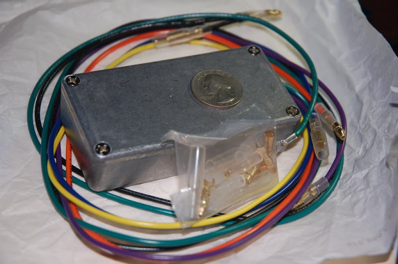

For what it's worth, I've got a Dyna-S on one of my bikes (K6) which has worked well for me but I'm going back to the points plate (and HondaMan ignition).
Another of my bikes (K7) runs great with the HondaMan ignition.  After my experience, I'm putting them (HM ignitions) on all my bikes.
Either solution is very good (Dyna-S or HM ignition) but I have to say I prefer the HondaMan solution.  Here's my list of reasons that fall in favor of the HM Ignition that I think are pretty indisputable (in direct comparison to the Dyna-S):
  • lower cost (68 vs. 125-ish)
  • easily go back to points on roadside in the event of a failure
  • better warranty (6 months vs years (forgot how many but at least 2 years and I'm thinkin' 5 years)
Here's what I'd consider secondary considerations that folks may wish to argue about:
  • Higher RPMs possible with HM Ignition (not too important for me)
  • slightly lower electrical load with the HM Ignition (I believe because "closed time" is shorter) (this is important to me for keeping my battery up)
  • I don't mind supporting a guy that has done so much for the forum (although I can't see how he could be making very much)  I know my bikes are in better overall working order because of his contributions and help
The bottom line is that if you have points, either of these solutions will make you smile about how your bike runs after installation.  The list of reasons to use either of these solutions compared to "just points" is a whole 'nuther kettle 'o fish.  For me, upgrading the ignition is a no-brainer.
John

Adjust your points pretty much once.
From what I understand, you have to wear out rubbing blocks (many thousands of miles) to make the points need any attention.  If they are brand new, it's good to clean the contact surfaces because they are under such low load (using the HM Ignition) they can't burn off the protective "gunk" put on at the factory.   I think HondaMan recommends using a business card with brake cleaner.  Just pull it through the closed points a couple times.
If the points are in "used" condition, you might want to "dress them up" a final time - clean with a steel nail file.  I found that points in really horrible condition worked fine with the HM Ignition but I subsequently cleaned them anyway (the bike livened up.. idled better, better cold start, seemed like snappier throttle response).
Here's my third one (going on my K8, quarter is in pic for perspective):

Well said, John!
It feels weird to see them in someone else's pictures.   :o

I've used S type ignitions with Dyna's 3 ohm coils for roughly 3 years, until recently when 2-3 coil took a *rap.
At first I suspected the early Dyna S. Sent it to them, they returned it fine. In the meantime I had tested the coils, and 2-3 had a high resistance (189KOhm) short on the secondary (HT to gnd.). They replaced the coil at a discount. I have one of the newer S  systems with the smaller modules as well. Both these S sytems were on bikes I purchased. I also enjoy using the points plate. Just not the adjustments that come along with it. I think the addition of 1 ohm ballast resistors is probably a very good idea on 3 ohm coils. I like the idea of an ignition system you can switch over to good old points if need be.

I've never had a Dyna ignition S fail on me, but I've seen a genuine Honda points arm break in half on a long ride, so I don't know if I'd carry a spare points plate, ot a spare dyna S, if I was going to ride around Australia.
I like Mark (Hondaman's) ignition amplifier, the one I had on my K0 worked great. I had an ignition amplifier on a V8 Ford many years ago, it worked great too, and I like that I could switch between the amplified ignition and the standard points, the difference in spark performance was like night and day. Cheers, Terry. ;D
