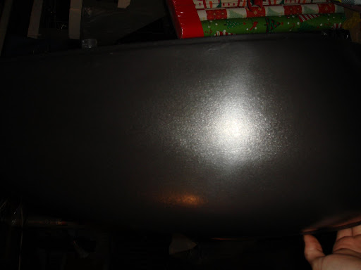

It's actually exhaust wrap coating. On the can it says it can be used as paint and sprayed directly onto metal, so I did.

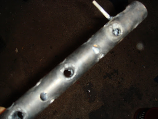

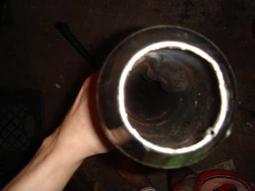

And the exhaust baffles? Yeah. Done. I think I'd do Martino proud with all the welding I've been up to lately.

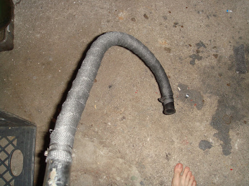

And I wrapped the pipes.
But only after I removed the stock baffles with a big freakin' chisel and patched up all the rust holes with band saw blade (for the patches) and clothes hangers (for filler rod). (Yes I am in my underwear, I took these pictures before getting ready for work)

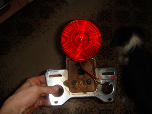

After that I got carried away with cutting things up and rethinking them. You know that big brick of a tail light? GONE!

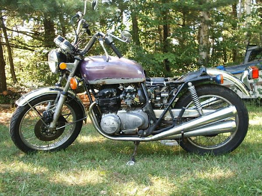

State when I got it:
