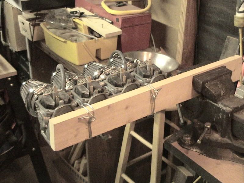

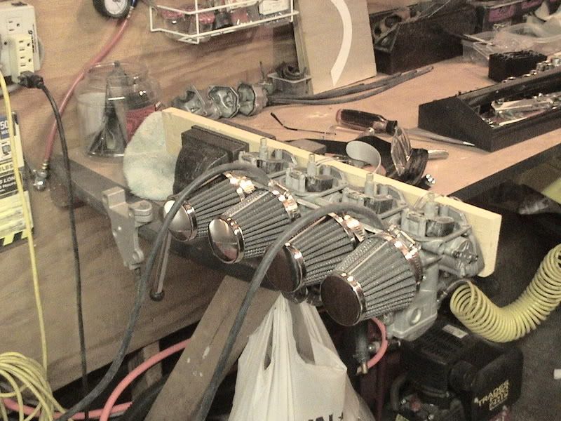

« Reply #21 on: August 09, 2009, 12:44:51 PM »
Don't laugh. To get the slow jets out, you do just that.  Though I didn't use tape, I just got a good hold on them with a small pair of Vis-Grips (needle nose type) and gently rocked them from side to side while pulling.  They came out fairly easily with not much damage.  To firmly hold the carbs, while still mounted to the rack, I strapped the carb rack onto a 1x4 and clamped that into my bench vise.
