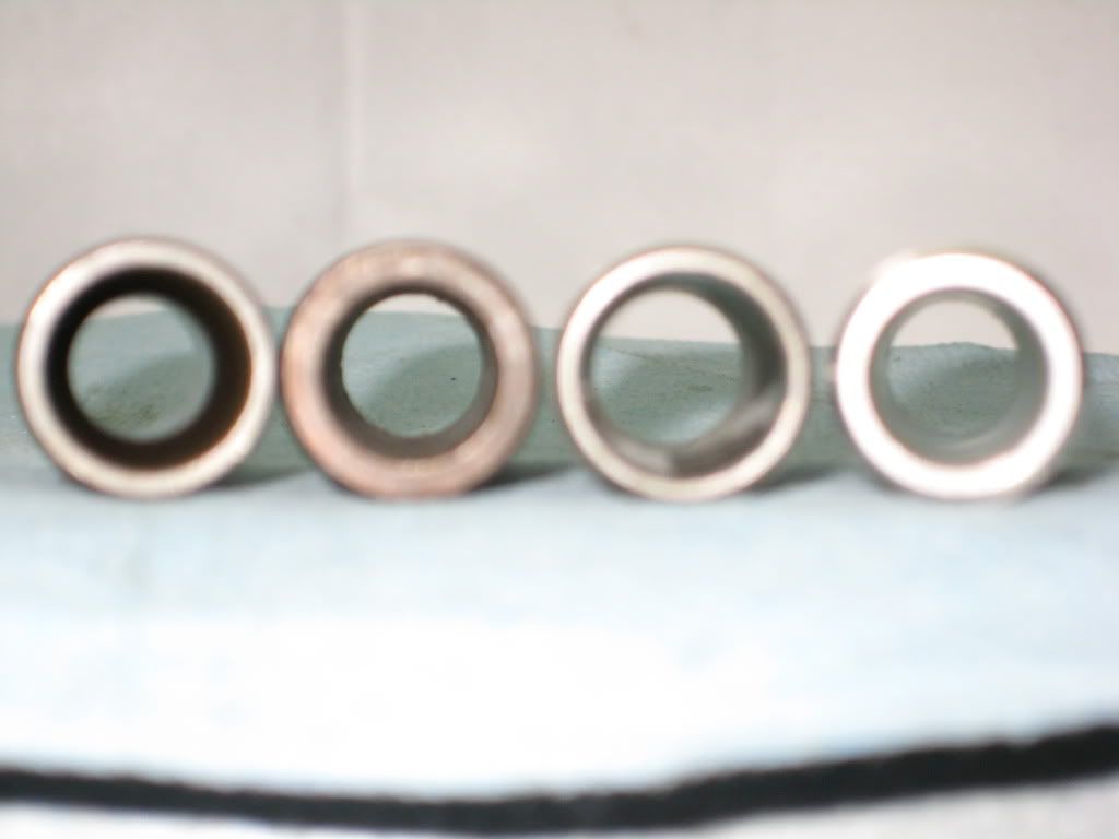

piston pins of my 1000ccm pistons.
the second picture shows the tapered version.
i feel, that one more gr could have been eliminated.
mec

mec
whats the internal diameter at the end of the tapered ones?
inner diameter is from 9.6 to 11.3mm
mec

Well I took Kayakers advice and ordered a GSXR1000 wristpin. I had a funny feeling it would be shorter in Suzukis search for less weight. Nice tapered pin but way too short at 45.4mm and 38g, I need 50mm. It is even shorter than a CB500 pin.
Two pix - Gixxer left, then stock 550, Wiseco polished 2-stroke tapered pin, and mine on the right.
Not sure I have the guts to use the Wiseco piece as it's not hard chromed but the lightest at 36g.
I wonder if Mec would let us know the length of your 1000 tapered pins and where they are from. It could be shortened from both ends and reduce that 39g nicely.
