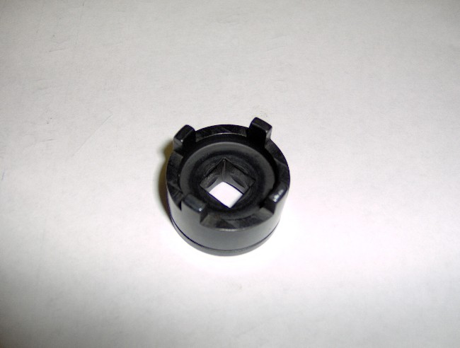

Yeah, that's more-or-less it.  The filters on those things aren't really "filters" imo but more of a sludge trap.   The special tool you need is for the retaining nut inside:
The tool that fits it is the same tool that fits the clutch center nut on a 750.  Cyclexchange sells them for about $15.00:
http://www.cyclexchange.net/Engine%20Parts%20Page.htm
Item #EN-615, about 2/3 down the page.

That tool is available at Motion Pro for less than $10 - assuming you're talking about an old Honda of some type.
http://www.motionpro.com/motorcycle/partno/08-0015/
