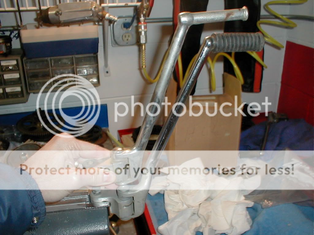

Here;s a 75 F
Note the turn out on the piece that attaches to the engine.

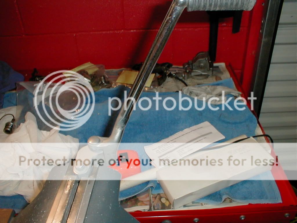

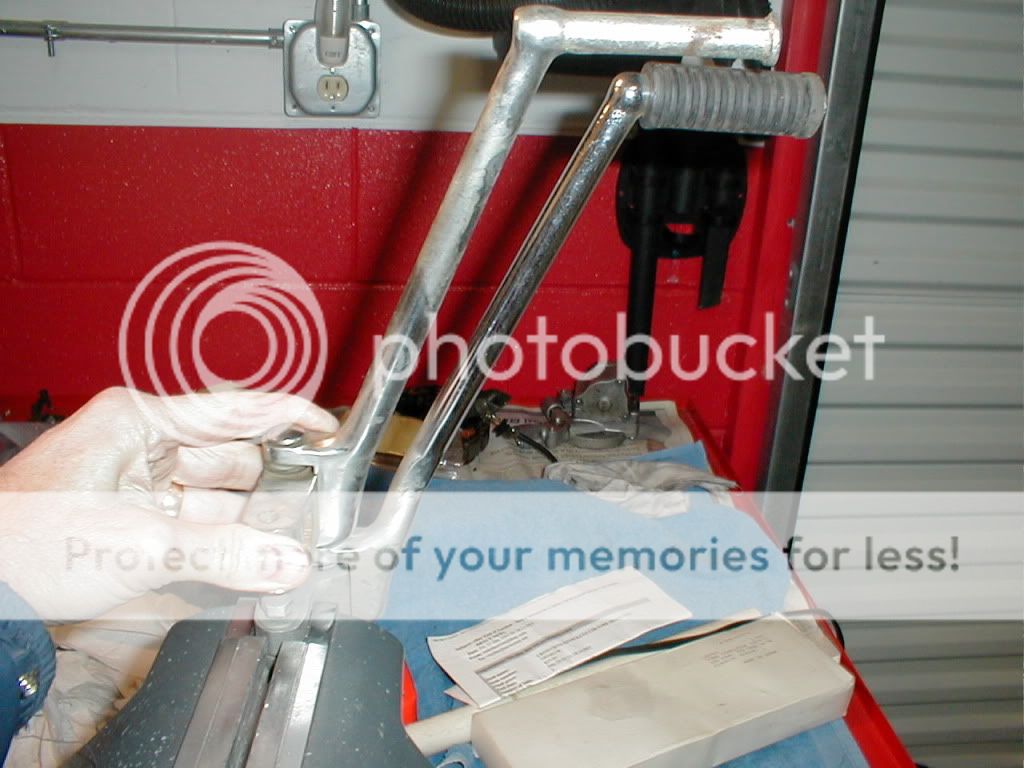

Here's a K overlayed on an F
Not much difference, but maybe enough. I think Honda did this for a clearance problem of their own.
A side shot showing that the F will lay forward a tad more when folded in.
This can probably be cured by mounting the F back a spline or two. It may not be a problem at all as they were the same engines after all.
PS: It looks like my F shaft may be bent a little.
