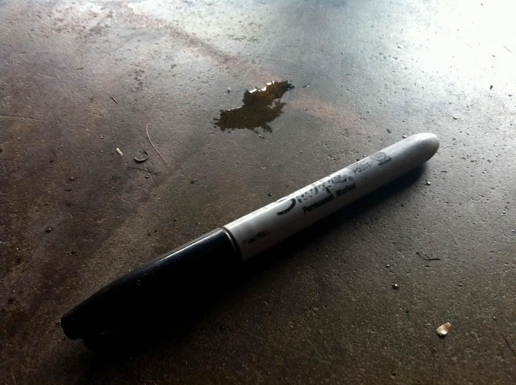

This is how much its leaking. I think out of the head gasket...I need to tighten it down more...but to do so I need to take off the tank and my fingers still have not recovered from putting the fuel line ON the petcock...

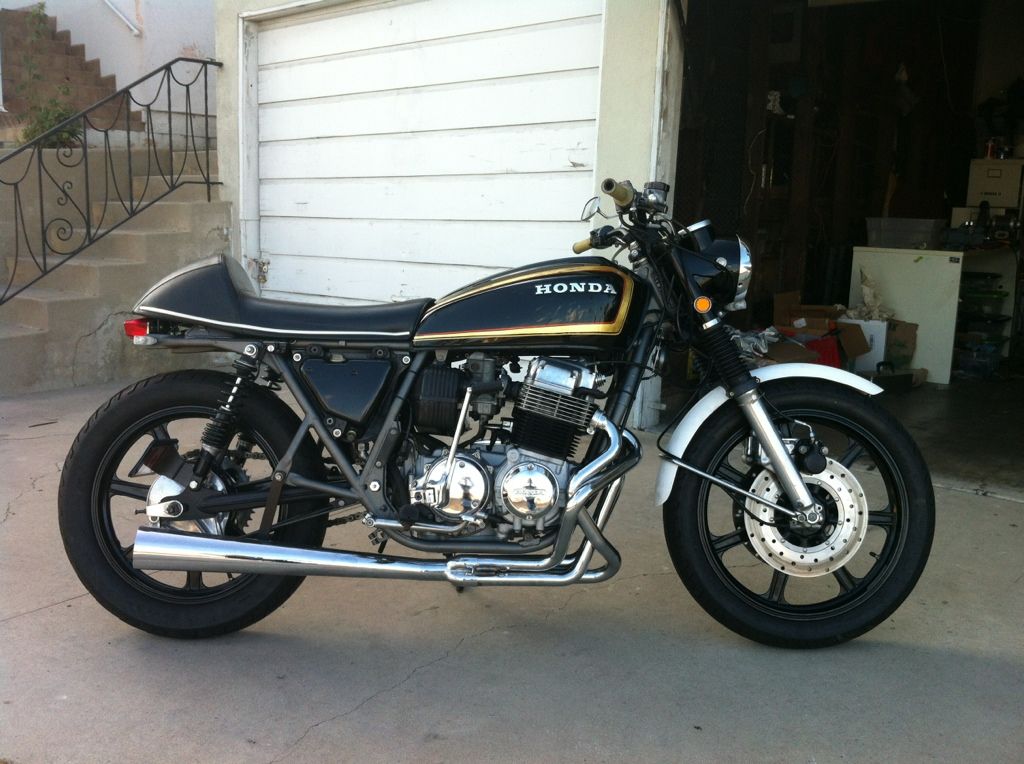

Front fender drilled and mounted. Still need to paint.

So after all that I'm not sure if I like the looks of the black fender at all...
Re-torqued the head cover....seems to be leaking less...but still leaking
looks damn good to me...or are one of those types who never plan to get caught in the rain

I want a front fender...regretting my choice to dismantle and give away the stock chrome one
Maybe black will grow in me. I'm tired of spending money
