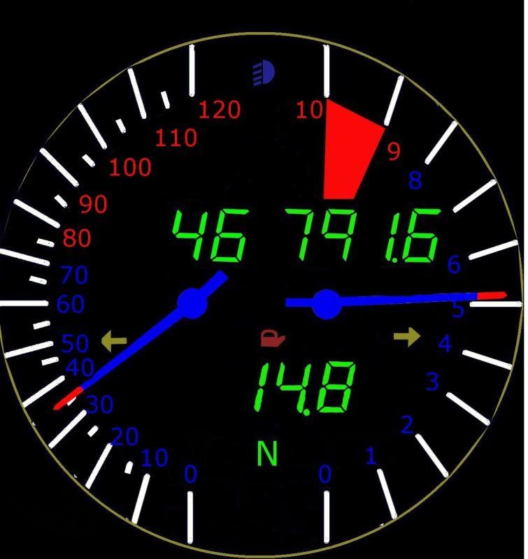

This is the rough board layout for the gauge, I'm trying to cram all this on to one board that size, that board doesn't even have the traces on it and I'm still missing parts on it, and with as packed as it is I'm not sure if its even gonna fit with out some other major movement of some displays and what not.
Also the hole blank faceplate template thing is what I was thinking of doing just send a plate wit hall the holes on it already and the person could do whatever they wanted to it.

I always liked the stacked style...seems like it would be easier to read...maybe with the Tach on top and the speeodmeter on the bottom
This old style was really cool too...lots of real estate for indicators

My main problem with a kit is that I am useless when it comes to electronics.  Absolutely useless.
Standard sizes don't matter to me, as this wouldn't go in a stock unit for me anyway (my ultimate plan is to have the gauge in my over-sized headlight bucket.
Yeah, I really like your first one.

I,m looking also to go digital -and idea is great .I would like to use original instruments (boath ) RPM and speed
but will like to  look it analog  only with oil presure indicator and km -trip ,How is posible to make  this  -build in in original speedos to omit gauges .

I like your idea with a single elegant instrument to convey revs, speed and distance (nothing else as too confusing) I would suggest only two colors, one for tach and a different color for speed so that they are easily distinguishable. Now they look the same and changing colors through the scale is really confusing and super busy. The two scales should have different number types and scaling so you can't confuse the two. at a glance it should instantly tell you what you need to know without taking any brain power to compute or analyze. Make it simple, legible and no pressure to decipher.
