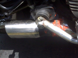

So, I replaced the stock muffler on my '76 CB750A with a resonator exhaust tip, which makes it a bit louder and throaty. I went out today to ride up through New Hope, Pa., and back through Frenchtown, NJ, filling up once along the way. On the way home, it actually ran dry and I coasted into a gas station. Since I am very new to this type of maintenance, where do I go for instructions on tuning it to the new exhaust system. It runs with power when it has fuel. What to check first, second, and third? Thanks.

Here is the video that shows leaking gasoline falling on the No. 3 header tube -- assuming the first cylinder is on the left side. Look for the black spot to show up on the driveway in the first 10 seconds of the video. If you look closely, you can see the smoke from the gasoline dripping on the pipes. I can't tell if it is the valve cover gasket or the head gasket, but either way, I think it is beyond my limited skills. Unless you know someone in the neighborhood who wants to tutor.
