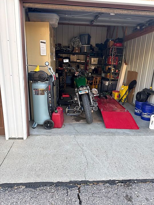

It's been a minute, but I thought I'd at least post the pretty pictures.
The headline is I was able to take it for a couple of shakedown runs!
I'll come back later, rearrange, and add some more detail about the shakedowns.
Nearing completion beauty shots.

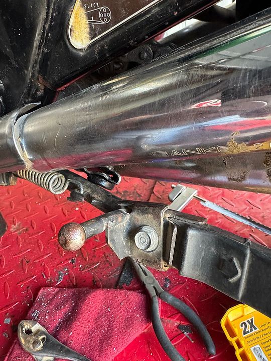

An interesting design choice by Honda. The CB650 Standard kickstand spring... peg... mount thingy is on the BACK of the frame plate. This kickstand is from a CB650 Custom; notice the hook for the kickstand spring is on the FRONT of the kickstand. I think I'm going to weld a small chain link to the back of the kickstand so I can have a side stand again. Relying on the center stand is not particularly fun.

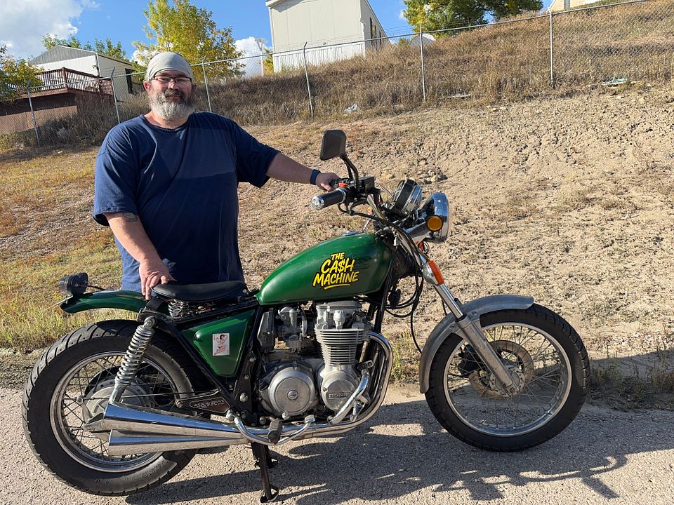

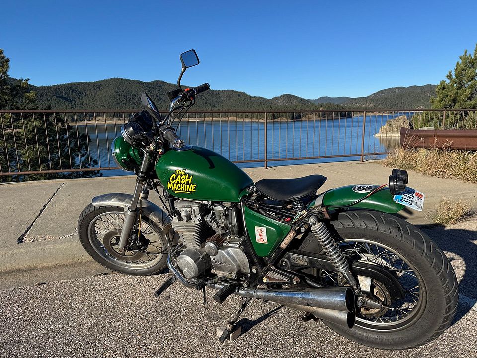

This build is nearing its end. The bits and bobs are almost sorted, and I went for a 75-mile ride today, with minimal moments of panic.
Posing at Pactola Reservoir in the beautiful Black Hills of South Dakota.

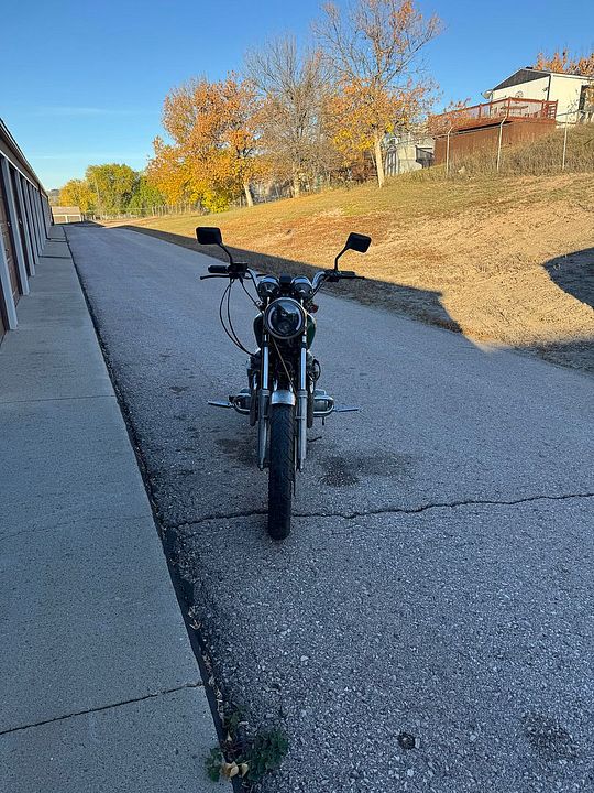

I deleted the stock turn signals and wired in the integrated headlight/turn signals. The front end is a lot sleeker now.
I also ran into issues with the kickstand. Caleb's modifications didn't work because the spring caught on the bolt behind the kickstand mount. I needed a stud on the front of the kickstand mount like the CB650C frame had, so I lopped off the stud behind the mount, drilled a hole and tapped it for an m6 bolt.
Just give it a little tap. Tap, tap, taperoo...
With this bolt in place, the kickstand works... like, 80%. It's a little loose when down, and I don't love that it doesn't really positively snap in the upward position.
If you look carefully, you can see that I used a persuader to bend down the bumper stop on the exhaust pipes. Even with that kinked down, it's still not quite in a fully upright and seated position. It has stayed up so far, even going over bumps, but I'll feel better once I cut off the stopper and it tucks in between the pipes a little tighter.
