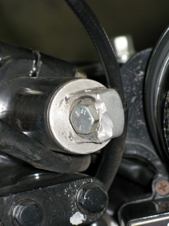

So, I’ve been slowly taking apart my $500 CB550F and I’m beginning to think maybe I didn’t get the better end of this deal.  It just seems awfully cobbled-up.  For instance, look at this front shock.  I don't think its original and neither did another member.  Looking at the shock the end is ground up for some reason and it looks like there is a hex bolt in the end of it.  Does anyone recognize these shocks?

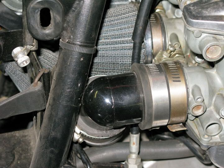

Then there are the breather pods, the two inner seat fine but the two outer will hit the frame so it looks like the previous owner rigged up some sort of 90° pvc pipe to miss the frame or could this have been part of a kit.  How does one miss the frame with these pods?

How does the bike run? There are many stories out there about how difficult it can be to tune these CB's with the "pods" on.
You may want to consider putting the stock airbox back on.

The forks like like they came from an early 80-'s Honda Silverwing. They were air forks and the PO capped them, there was a hose between each fork. That pod set up is unbelieveable, either get short pods or convert back to the standard air box.  good luck with the project, Larry

I have air pods on my 550f and the two outer pods dont fit right they are little big so i had to just bend them alittle to fit but they hit the frame alittle no big deal thow they work just fine.
