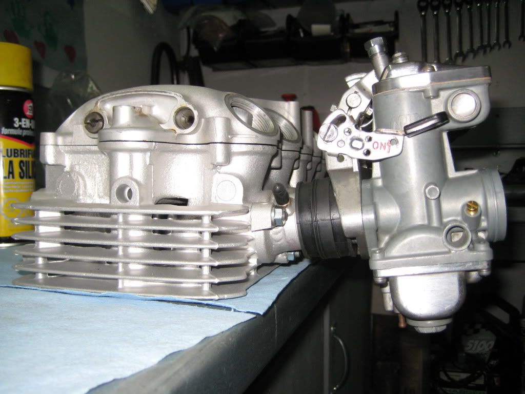

I believe the first three year Z1's used VM28's. These carbs are similar to the Keihins on the CB500 with the external adjusters and aren't known to hold synch well. Then they went to VM26's, on the KZ900/1000's I think until 78?? then back to an improved 28mm with a pump.
The early VM28mm command big prices but the VM26 are a dime a dozen, I'm not sure these will do much for your 750. They have a full round venturi nearer 27mm in size. However 29mm smoothbores would be the bees knees except these are very rare too.
As MCRider mentions Dynoman has the intake manifiolds for the conversion.
Top are the early VM28 with the center drain, next are the VM26.
