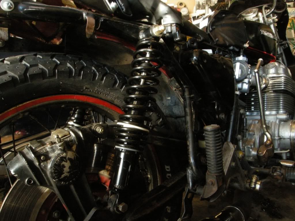

Put on my new Cycle-X shocks (look great!) and did a road test.
Very stiff--almost rigid--but I'm not complaining.

These are the chinese emgo shocks.
They might work OK for a while on a bike that weighs as least 800 lbs.
The lowest preload setting is only a few degrees away from being a rigid strut. Highest preload, may as well use rebar and save your 75 bucks.

You do know you have them set on the highest preload, try turning the adjuster and let the spring move a bit.

How much do you weigh?  If you're 160 lbs., that's kinda different than 220 in terms of how a shock behaves.
No difference, honestly, with these.
My friend who weighs over 200, on a 500ish lb bike, gets beat to crap with these things on. They are still too stiff even with his girlfriend on the back.
At the lowest setting.

They are adjustable for preload, that is not a spring rate which is only adjustable by using different spring, preferably of the correct rate.

You can probably source a correct length and lighter spring from a specialty spring shop. Springs usually aren't too expensive and it'll definitely make all the difference.

I just bought a set of these shocks as well. I was attracted by the lure of the price tag, and the fact that you can
get them in all black. So they showed up, and yeah, the old saying stands true, you get what you pay for.
My bike is nowhere near being put back together, but I can tell these babies are gonna make my baby elephant ride
like a haywagon. Especially after all the weight the bike is going to lose (and the fact that I way 160 lbs).

I think everyone sells the same version of these Chinese shocks, priced around $100.
I think they're stiff as hell and don't really give a nice ride. Struts are as good a comparison as any.
And I think if you're talking about different springs with these things, you're really spending good money after bad.
