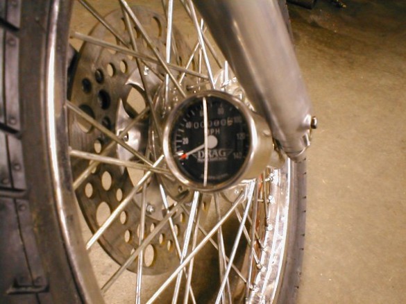

For the speedo, Cyclexchange makes these:
Available here:  http://www.cyclexchange.net/Frame%20Page.htm
Mini speedo attached to the front wheel drive unit. We think this is soooooooooo cool!
Frequently asked questions:
Question: Can you see the speedo while driving down the road?
Answer: Who cares.
Question: Is this legal?
Answer: Who cares.
Question: Has this ever been done before?
Answer: Maybe, but someone will copy this. We care a lot.
This super innovative speedo kit  includes: Speedo, adaptor, and special cable.
                                                  $ 89.00            # FE-407
