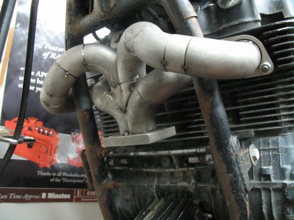

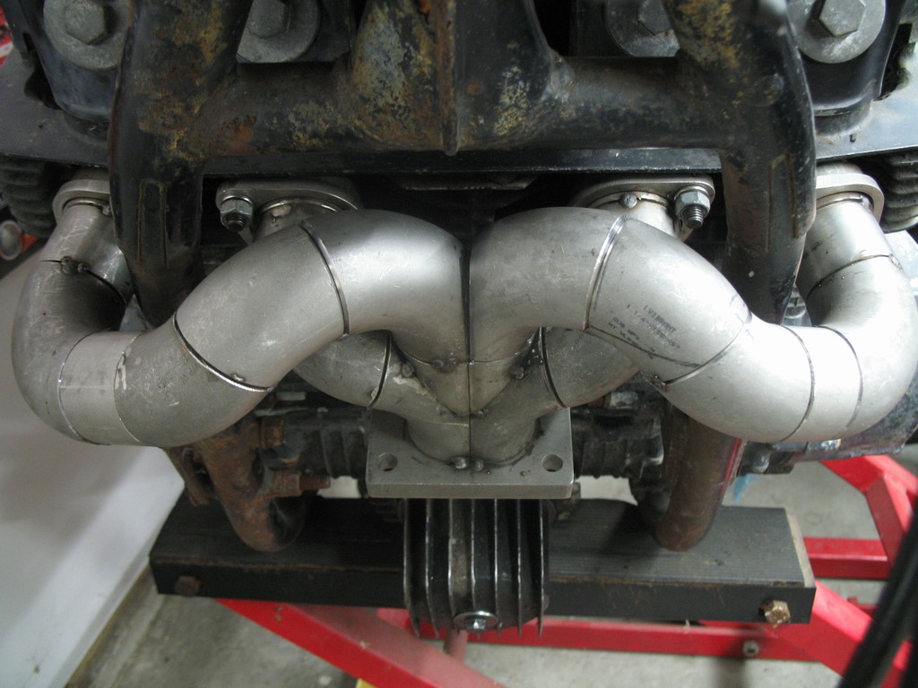

well i think i may have found a guy who can make me the manifolds i will need for a good price and now i just need to decide on the components like the turbo and carb. i was wondering though what would be better the blow-thru or draw through?

Hey Orkid,
Regarding the blow thru vs draw thru, that subject get tossed in the ring quite often in the turbo bike realms.  It’s kinda like the oil threads.  Simply put, they both work and if setup properly both work well.
I guess it comes down to what resources you have available.  If you don’t have any welding or access to fabrication weather it be from yourself, a friend, or paid help then you’re setup is at the mercy of what you can purchase.  If you do have access to fabrication, as you note you do, then your choices expand and the limiting factor comes down to budget.
I think blow thru gives you more flexibility for mounting and choosing your turbo, it can be mounted anywhere on the bike and can also make use of an intercooler.  If you choose draw through you should choose a turbo that has a carbon ring on the compressor as noted by Blue and its best to keep the turbo in close proximity to the intake manifold for better fuel atomization; which might work great if you want the turbo mounted behind the motor.
All I know regarding cams (limited) is what has been noted above by buttcan and Blue, that being little overlap is desirable (the period of time both intake and exhaust valves are open at the same time). I believe this limits the pressurized intake charge from pushing the air/fuel right out into the exhaust.  The cam that Sam pointed out does well in this area, with only a few degrees of overlap.
I have had luck using the stock carb rack on my setup.  With a little prep the stock cable slide carbs seem to work well.  CV carbs would probably work better if going blow thru, but if you are budget limited using your stock carb rack is an option.
A good resource for turbo bike knowledge and information is here: http://forum.oldskoolsuzuki.info/cgi-bin/Yabb/YaBB.pl?board=forcedinduction

Another resource to looking is the Moto GPwerks member that posts on this board. Last I read they are or were making a draw through kit for the CB. May want to contact them and find out, estimated price was quite reasonable for their kit.
In my spare time I’ve been looking to create a kit that’s reproducible as well, we’ll see where it goes.  I wish I could help ya out as well but don’t have anything to that point yet.  I picked up pushing header again the last few weeks when time permits and have a basic shape that I’m happy with.  The top right 90 and wedge under it needs to be reworked yet to merge better (gapped a bit currently), but a weld jig followed by cut jigs are next on the list. The real challenge comes with the cut jigs, there are some challenging parts to recreate. That success or lack there of will determine weather it’s a one off, scrapped for something else, or something that can be reproduced.
Schedule 10 stainless butt weld els make the tight turns possible without cheating the bends. This allows the turbo to clear the oil filter and stock front fender.  Should be fully argon back purge welded.  This guy is setup up with a T25 flange, a Garrett GT1548 is the turbo that I’ve been using for test fitment/clearance.
Would like to see how an inline intercooler running along the left side to the air intake/carb(s) with an air scoop to divert air through it would work to save making a plumbing jungle gym.  All in all it’s been a fun fab project.  If anything maybe you can use the pics to get an idea for your fab guy to work with.
