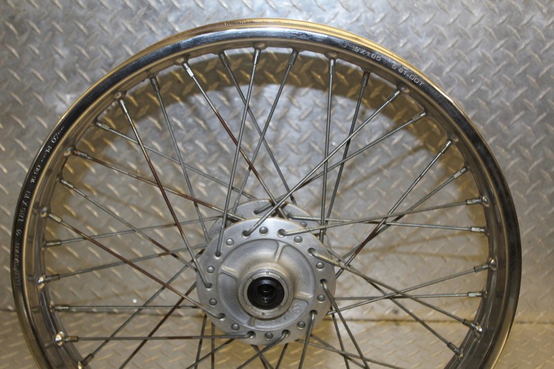

I don't know of any fully "bolt on" ways to mount a wire wheel in mag wheel forks.
I know of one way, but you lose the dual disc. There is a model of 1979-1982 cb750K bike that uses a wire wheel compatible with the dual piston caliper:
the problem is that the backside of the wheel doesn't have a surface to mount a disc even if you drilled through the wheel:
So if you had a K bike with a single brake and you wanted to upgrade to a better single brake without losing a wire wheel you could use a 1977-78 F front end (Forks, trees, axle, etc), the left side 1981-82 dual piston caliper, and this 79-82 cb750K wire wheel and spacers and (might have to mix and match spacers with 77-78F setup) and end up with better braking. Is it as good as dual discs? no I don't think so, but it is better than a swing caliper single puck.
and just to give you an idea as to how rare this wheel is, these are the only models that used this front wheel that is compatible with the later dual piston caliper:
    1979 CB750K A - FRONT WHEEL
    1980 CB650 A - FRONT WHEEL
    1980 CB750K A - FRONT WHEEL
    1981 CB650 A - FRONT WHEEL
    1981 CB750K A - FRONT WHEEL
    1982 CB650 A - FRONT WHEEL
    1982 CB750K A - FRONT WHEEL
« Last Edit: February 23, 2017, 11:11:47 AM by Geeto67 »
