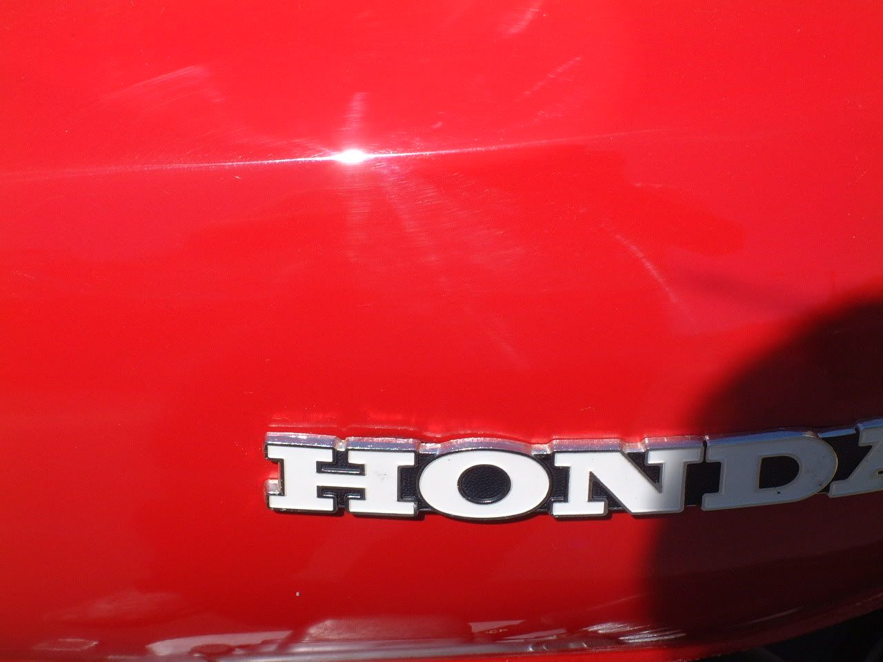

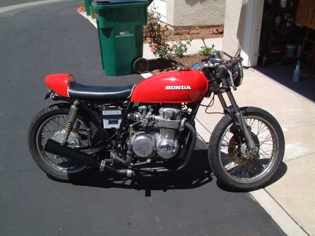

I recently did my tank with DupliColor rattlecans.
Strippped the tank down to bare metal. Sanded the areas that needed bondo with 120 grit. Bondo'd,  feathered with 180. Wiped down the tank with a RepliColor cloth. Sprayed three coats of DupliColor buildable primer, 4 coats of DupliColor red, and four coats of DupliColor clear engine enamel. (The color and the clear aren't technically compatible with each other, but if you spray all coats within an hour of each other it works.)
Let everything dry for seven days, then wet sanded with 1500 grit. For a long, long time. (As an experiment I may someday try 1000 grit to begin with and switch to 1500 after most of the orange peel is removed. Don't know if that will leave scratches or not.)
I sanded until the orange peel was all removed (checking by occasionally wiping the piece with a dry towel) and then polished with McGuier's #9 swirl remover on a power polisher with a Turtle Wax foam pad.
The result was better than I'd hoped; I'm very satisfied. It isn't a showroom finish though. It lacks depth, and it's not very resistant to gas. I did some test pieces and found that the standard DupliColor clearcoat has no resistance to gas, while the engine enamel is a bit better. I still have to hold my hand under the gas nozzle a la Easy Rider.
Most of this stuff came from Chuck Hawk's motorcycle painting FAQ, BTW. Probably worth reading.
Also, I understand Harley sells rattle cans of laquer. I may try that next time, but they aren't cheap.
« Last Edit: April 12, 2006, 12:38:27 PM by Noel »

« Reply #5 on: April 12, 2006, 12:32:16 PM »
yea,lacquer is pretty much mistake proof.
Gimme a can and I'll prove you wrong!  :D
Here's a couple of pics of my rattlecan paint job.
(Gotta go to Pep Boys today and find some screws for the front fender. Excuses, excuses.)
