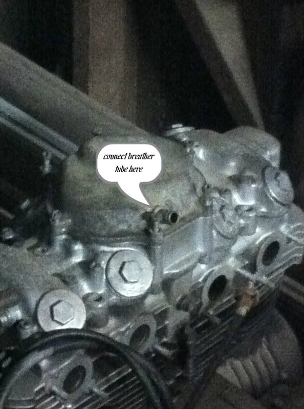

so here is where the breather hose goes. this pic is from the carb side of the motor. Mine just routes down  in front of the back tire. i blow steam on hot days puttin around the city. Never really looked into why, as its only happened 2-3 times over the past 3 years. now I'm curious  :-\

I'm reasonably sure the steam isn't venting from the crankcase breather, I spent a good 10 minutes yesterday tracing the source with a piece of cardboard and a flashlight, it's definitely coming from under the tank towards the seat. I'm going to pull the tank off tomorrow and have a look, I spent all my bike-tinkering time tonight tracking down a bad front stop switch connection.

there shouldn't be anywhere that vapor could come from besides the crankcase breather. maybe the breather is clogged (slightly common) and its forcing out a weak spot in a gasket? i think id expect oil with that though. same would go with a crack in something... or maybe they put the cover that the crankcase breather attaches to on with out a gasket, i don't remember how much oil gets up there... i think its little to none though, could be wrong.
