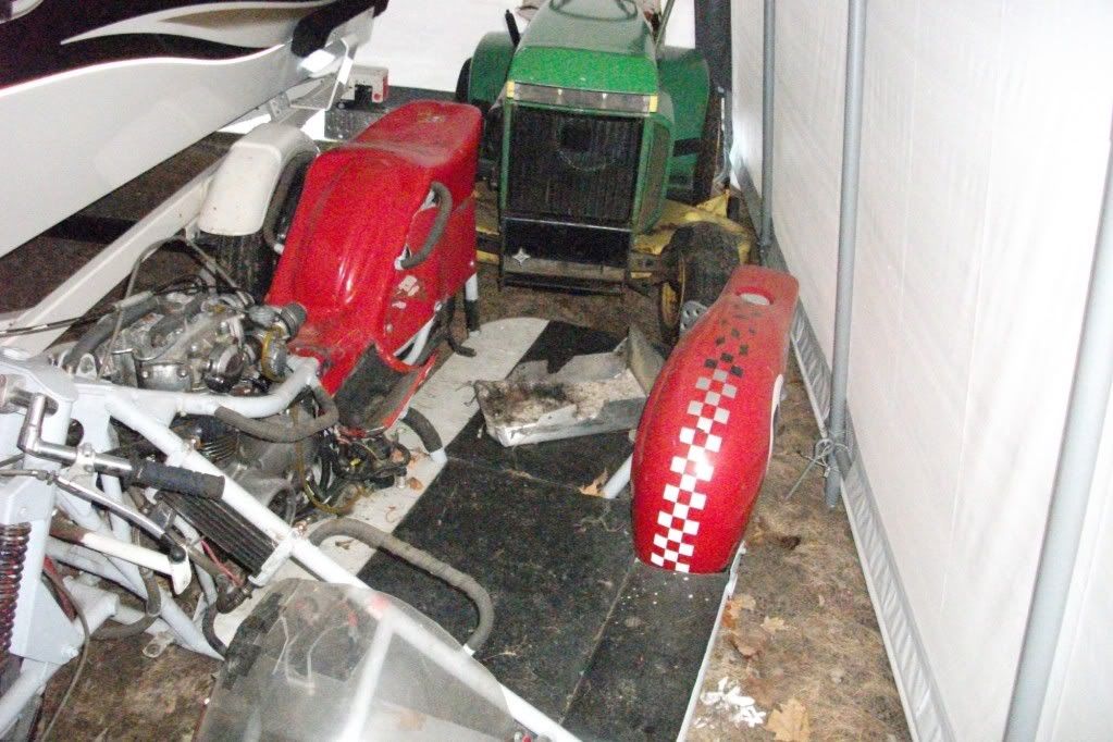

« Reply #16 on: September 28, 2011, 05:06:49 AM »
Sorry for being tardy with the pics.
We are in the middle of selling the pub and things are a bit hectic.
Cheers,
Brian
Offline bear
  • Posts: 2,577
  • Leeton in Australia
Re: Honda powered sidecar - options???
« Reply #17 on: September 28, 2011, 05:10:04 AM »
More pics
Cheers,
Brian

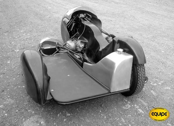

Oh, you think that cap on the chair wheel fender is a gas cap. ;)  That's for filling the keg! ;D ;D ;D
Great pics bear, thanks.  Couple of questions.  It looks like the brake balance bar is for the rear & chair wheels, and is left foot braking, with shifter on right?
Yep your right.
Originally all the brakes where intergrated with the bias on the rear and chair, but the powers to be changed the rules and we where forced to run the front brakes as a separate system. It caused us no end of problems.

So I have finally found and purchased a sidecar for the 2012 season, it runs in our P2 class.  This would be similar to P3 down under, but with a 750cc displacement limit.  Once I have it home (in the new year) I'll start a rebuild thread in 'other bikes', as it's Yamaha XS650 powered. ::)  Although the rules allow 15" spoked & 5" tread, everyone runs 16" & 4.7" Dunlop sidecar tires.  The chair wheel is a 10" Mini rim.  One interesting point is that the front and chair wheel operate together (with a bias adjuster), and the rear wheel brake is separate.
What it looks like today, after sitting for 3 years.  Lots of work ahead, before sidecar school & the 1st race in June.  At least I won't be straining my neck watching for bwaller coming through. ;) ;D ;D ;D
It has a dustbin fairing that comes with it (not fitted here).  The bars will be updated to a set of clip-ons mounted to the forks.  I'm also going to change the ridged tach mount to something with rubber cushioning so it lasts more than a few laps.
This is what it will look like with the fairing fitted, same chassis.
