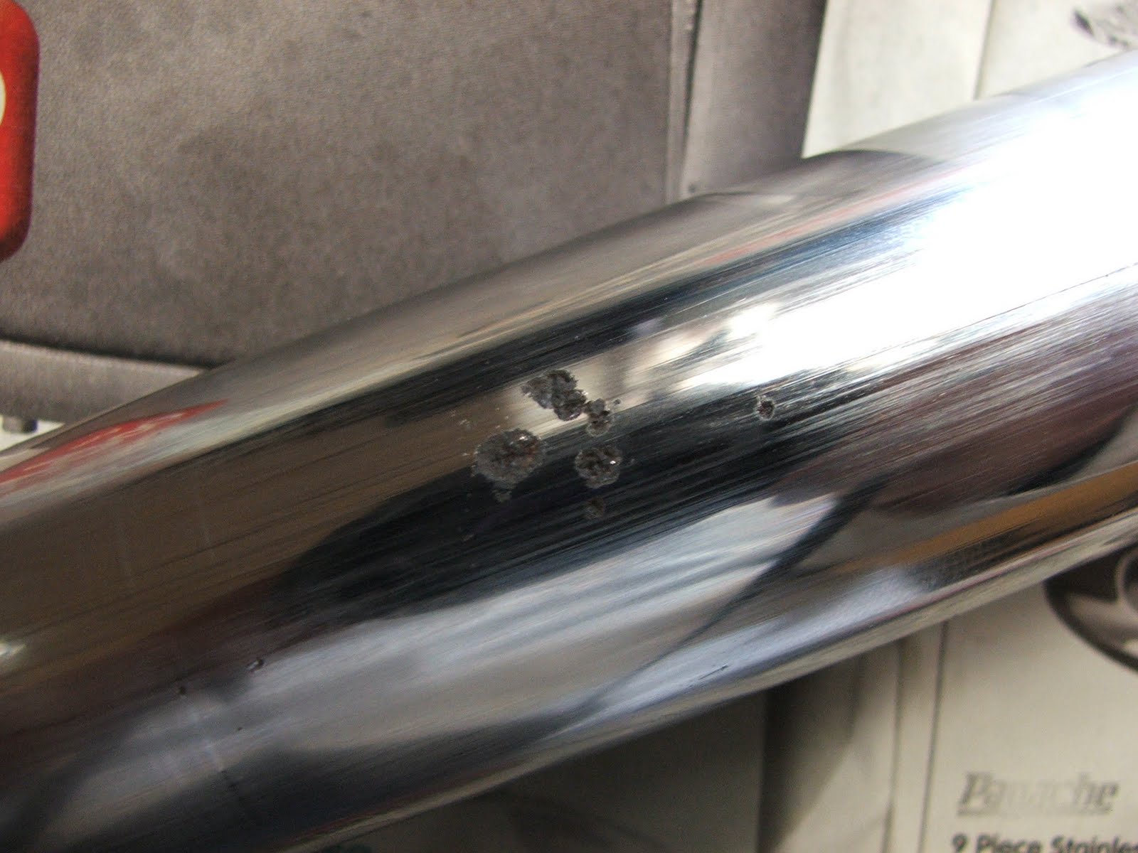

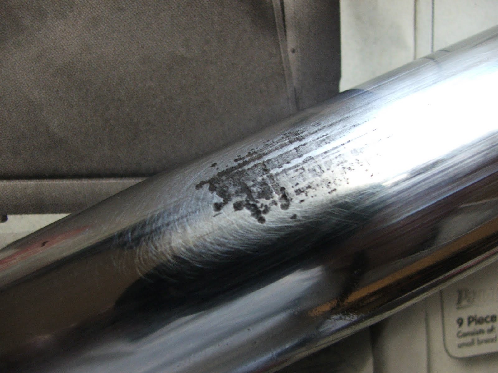

I'll try to get a picture of the pitting for yalls advice.  I believe it is minor enough for this method.

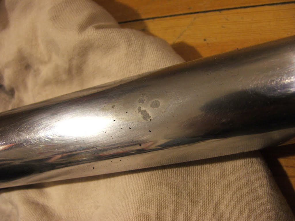

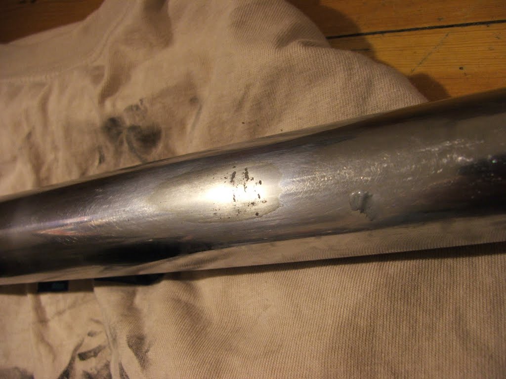

My before and after shots:
(Black spots are polishing compound specks, only noticed after taking photo)
See http://coffeeracer.blogspot.com/2011/09/fork-rebuild.html for more.
Pitting was pretty bad (on 3 sides) and I'm not sure how the repair will hold up, haven't been able to do more than ~200km since. Personally I would replace with new or 2nd hand shocks in better condition, rather than go through the trouble of hard-chroming them.

You can't repair those with hard chrome as the pits are too deep and if you ground out the pits the wall thickness would not be good enough and the forks weak
