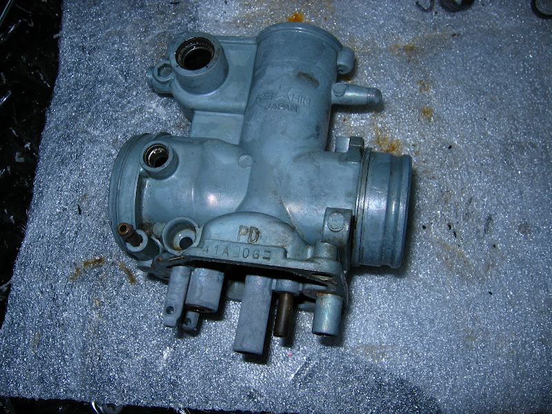

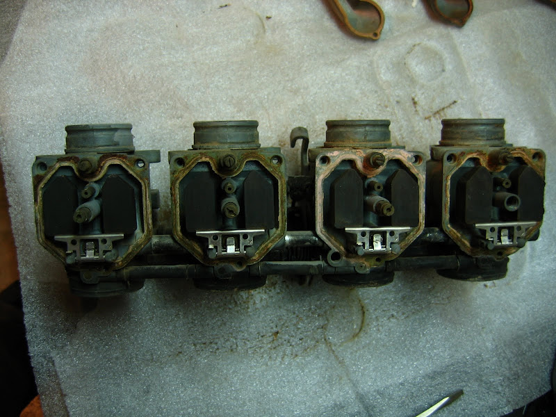

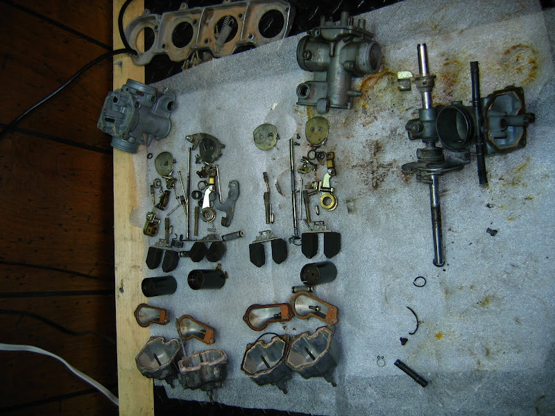

ok, last night, made some progress on my carbs.  i got most of them disassembled in the short amount of time i had, and i must say that i'm quite surprised with the effectiveness of the ultrasonic cleaner i have!!
here's a link to my picasa albums, so extra pics are posted in there that i can't necessarily get on here:  http://picasaweb.google.com/106056913584549886552
now i have some questions:  where do you get some felt that can replace the stock stuff?  i know i need an "A" grade felt, but i can't find any places here in the states that carry it.  i've called the local fabric and upholstery shops, and NOTHING!  nobody has even heard of it!
also, the rest of my internals look fine so i'm just going ot get some OEM gasket replacement kits and be done with that.  i'll order an accelerator rebuild kit from TAS motorsports, as they have a good deal on them.  How can i check my pump first though to make sure everything is working properly??
ok, here's some pics:
carbs as i received them: Thanks Shennanigans!!!
underneath the float bowls:
before ultrasonic w/ heater:
during ultrasonic: this helps those who haven't seen this before (i used about 1 part simple green to 5 parts water)
after ultrasonic: i didn't do hardly any scrubbing here, i just wanted to test it's ability
and a comparison:
where can i get replacement screws and stuff for the individual components of the carbs?  i had to use my trusty Irwin screw extractor,
to remove screws in both the needle retainer in the slides and on the butterflys,
Also, what are these little plastic pieces on the butterfly rod?
additionally, how do i sort hour these two springs on the butterfly return springs between #2 and #3 carbs?
finally, heres a shot of what i was left with before heading to bed last night:
thanks guys!!

two things to check with the acel pump. Visually check it for deterioration and for function to make sure the opening are clear and working on some carbs you can fill the float bowl of the carb with the pump and manually pump it. You should see a little gas come out near the intake side of the carbs.

« Reply #20 on: March 08, 2010, 10:58:17 AM »
ok guys.  weekend was full of unpleasant surprises that hindered work on the bike of any kind.  friends car died, computer motherboard crashed, forgot about plans with the gf, that kind of stuff....  either way, i've had NO luck finding that throttle cable holder that fits on the carbs.  does anyone have any ideas about where i could find one, or if i could make one out of some flat stock?  i wish i had measurements of the stock piece, that would make things a lot easier to try and replicate...  i attached a picture of the piece i'm looking for.  or am i just freaking out about this?  i've seen so many on e-bay and other places that don't have them...
onto another question area.  does anyone have any advice on a stock jetting selection?  i'll need to check what the main and slow jets are currently.  the needles are on the top (farthest from the point) notch.  i might try and drill out some of the holes like Hondaman suggests in his book.  but i don't know where to really start from the tuning perspective.  i'd like to get these guys really clean and put back together so i don't loose any parts and i can use the workspace for something else!
one other thing, what's the best way to clean off the floats?  i don't think sticking them in the ultrasonic cleaner would be the best.  i was thinking of just spraying them off with some carb cleaner and then shooting them with some compressed air, CAREFULLY, i know!  then i'll set them to the factory specs for float height.
« Last Edit: March 08, 2010, 11:07:39 AM by wannabridin »
Offline climbingaz
  • Posts: 379
Re: 1976 K Build - A lesson in patience... (new pics 3/3/10)
« Reply #21 on: March 08, 2010, 11:25:31 AM »
Hey Wannabridin,
I recently rebuilt my '78 750k carbs and yours look mighty similar....I'm guessing you decided to go with the pd carbs instead of the stock '76s?  If so, I might be able to answer a few questions while stuff is fresh in my mind.  If you haven't already done so, you're gonna want to track down some new/used carb intake boots.  I don't think the '76 boots will fit the carbs you have.
Good luck with the build!
Offline wannabridin
  • Patience made me a
  • Posts: 2,237
  • -Garrett
« Reply #22 on: March 08, 2010, 11:56:38 AM »
climbin, thanks for the chime in!  i am going to go with the PD's instead of my stockers.  i have a set of carb boots for the carbs, actually got them for $25 on ebay, and they're still pretty soft!!  i'm going to see how easily they slip on, but i don't think i'll even need to renew them in wintergreen oil!!!  i was SO pumped about that!!
any advice you can give me is awesome!!  what'd you do about the felt washers on the choke rails and on the slide rails??  also, what about the throttle cable bracket i've been whining about?  do you still have yours?  or are you running without?  anything i need to watch out for?  what are the specs on your tune?  anything and everything is greatly appreciated!!!  don't feel bad for typing a lot, i love getting good long replies!!!   :D
Offline climbingaz
  • Posts: 379
« Reply #23 on: March 08, 2010, 12:54:00 PM »
I'll try to answer what I can:
1)  carb boots - excellent score off ebay for $25.  Mine were hard as a rock, had to do the 'ol wintergreen trick.  If you have any problems mounting yours, you might want to give it a try too...just to soften them up a little more for the install.
2)  felt washers - when cleaning my carbs, I took them completely apart and just reused the same felt washers.  I've since reinstalled the carbs and have no leaks.  You obviously don't want to dip the felt in any cleaning solutions though.  But if you need new felt, I've heard you can just buy some from a crafts store and try to cut them out to fit like the originals.
3)  throttle cable bracket - I'm not sure how you would go about mounting the cable without the bracket.  My carbs have the bracket and I'm definitely using it.  Might need to go back to ebay or a junk yard to find that sucker.
4)  tuning - keep in mind that I just got my bike running a few months ago and still have a lot left to do before its roadworthy.  It had been rotting under a tree for the past 15 years before I bought it last June.  But as I got the bike it had 125 main jets, pod air filters and an aftermarket 4-1 header.  At first I had intentions on running pods and bought new ones for the bike.  But after I got the bike running I just couldn't get it tuned right.  After consulting a few guys I trust, I decided to go back to a stock airbox and stock 110 mains.  The bike runs SO MUCH better now.  If you do decide to go with pods, just be prepared to be patient and understand that the jetting can be time consuming and a bit tricky.
