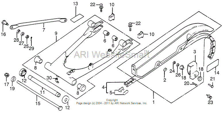

 (B)  I was looking for swingarm bushings and see that Z1 lists a swingarm bearing kit. Contains 2 Needle Bearings 2 Thrust washers and 1 Shaft.
   I really haven't seen this talked about much. Think just replacing the bushings will be OK?
  Looking at the parts diagram, I don't even SEE any needle bearings. Is this an upgrade or ???

The needle bearing kit is not a direct OEM replacement. It converts from OEM style bushings to needles.
There are schools of thought about this. Needles are used in all modern swingarms I know of. But they are factory designed and sealed. And they have well designed lubrication.
If you put needles in the CB, they may rust up with infrequent use and poor lubrication. They aren't as large as the newer factoiry ones, so bushings may carry the load better. They sound neat, but i don't know of anyone who has used them. I'd like to hear. In the meantime I am happy with the bushings, and HondaMan's upgrades to the install and greasing function.
