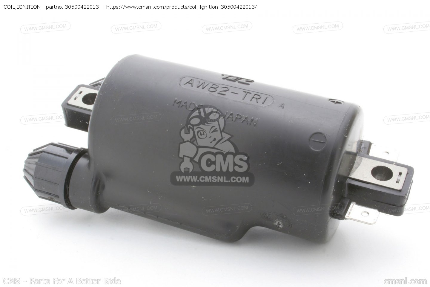

Some resolution at least. The ignition coil is officially dead, no spark from either 1 or 4 plugs.  Coil to wire joints where not in bad condition. Caps where reading right on 5 ohms, but when I reassembled everything I got no starting and only the 2-3 pipes getting warm. I pulled the 1-4 plugs individually, grounded them out on the motor and saw no spark at all.  I think HondaMan hit the nail on the head once again, that coil was going, going then gone. So moving forward, where should I look for new ignition coils. I would like to replace them both, and preferably with something new. Any links to available options would be greatly appreciated!
Offline HondaMan
  • Posts: 15,020
Re: Can someone actually help me?
« Reply #20 on: December 03, 2011, 04:00:27 PM »
Today's version of Honda's own coils are actually much better than the 1970s version. They also give a longer duration spark than any of the aftermarket coils, and are always my first choice on a rebuild for someone, even a racer. The coils are good past 14k RPM.
The other options out there each have issues: the Dyna 5 ohm coils are pretty good, but have a shorter spark duration than stock coils. The Dyna 3 ohm coils make more voltage, but if the plug caps and wiring is good in the bike, there is little or no difference from the voltage change because the duration of the spark is VERY short unless you add some things to those coils. Those 'tings' are: add a series resistor to the power side of each coil, 1 ohm (this is even Dyna's own recommendation for the SOHC4 bikes), and change the plug caps to 10,000 ohms instead of 5,000. These two things together will let the 3 ohm coils generate about 1.1mS spark duration at about 25kV at the plugs, but the stock coils make 1.2 to 1.5mS duration, much better in comparison. The stock coils make about 7500V (7.5kV) spark, but these engines (stock) only need a little over 4kV to fire and run well.
The main advantage of the Dyna coils is in the long run: the wires can be replaced, where the stock coils won't let you change them.

The GL1000 coils are awesome replacements for our bikes.  With little effort they will fit the stock bracket, they have replaceable leads, and they produce a very nice spark.  I have them on a cb550 and 2 cb400f's with zero problems.
The only modification I had to do was cut off the little plastic surround on the two end grounding/mounting lugs.  Then it bolts right in.

make sure what ever coils you get the primary resitance is 5ohms,,in your reply i think you meant your caps have 5000 ohms or 5kohms?

GL 1000 coils are not 12volt as they run through a ballast resistor on the GL so yes they will give a great spark as they are being over voltaged but who knows for how long
  • Posts: 17,215
« Reply #25 on: December 04, 2011, 12:37:46 AM »
do the gl1000 run a 12 volt on crank/start and say 8-10 volts on run via a switchable ballast similar to older cars bryanj?
Offline bryanj
  • Posts: 14,759
  • CB500 Number 1000036
« Reply #26 on: December 04, 2011, 06:55:43 AM »
From memory yes Dave, I do have an "executive" to re-buid sometime and at least 2 Honda manuals here so given incentive i could look it up!
