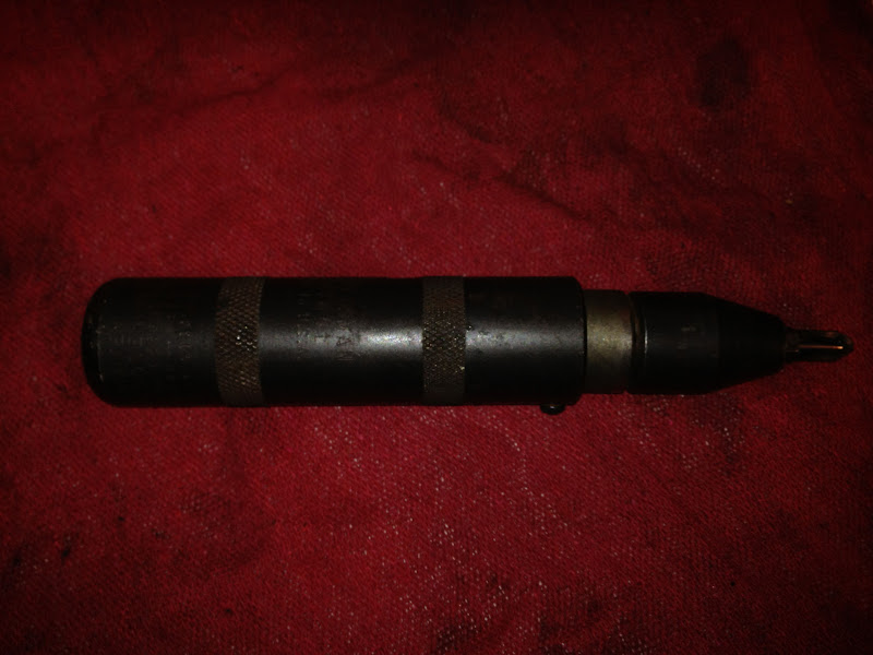

3 days later, a can of penetrating oil and probably a hernia, I had 2 screws out of the cylinder head cover, and gave up for a while :P I knew my dad had an old impact screwdriver lying around from back when he had his bike, and I was waiting to get that from him (too cheap to buy my own, I know I'm pathetic), once I got a hold of that, my life would never be the same:

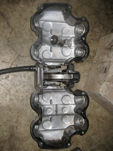

In no time at all, the rest of the screws were out, and the cover was off:
Pretty oily in there, but it seems to look alright, as far as I can tell.  Should it be this wet up there?  I got the rocker arms off next.  I didn't have the "tool" to remove the rocker arm shafts, so I just used a dowel I had lying around which I'd previously used on my carbs.  Worked like a charm.  All but one shaft came out without too much extra effort.  And finally I got the cam shaft out.

I was going to say get HondaMans book then I read about the impact driver ???. However it would be a good tool to invest in the book that is. :)

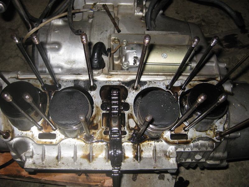

Back at it tonight, made some more progress.  Got the cam out tonight.  Honestly the biggest pain was getting the camshaft holder out.  The shop manual just says "remove the camshaft holder" as the instruction.  Well that would be fine and dandy if it were that easy.  I wasn't entirely sure if there was anything to be wary of on the underside, so I took it real slow, and eventually got them to pop up and off.
Then lots of bolts, including those tricky ones hiding under the rubber pucks.  Luckily they were pointed out, or it might have taken me a bit to figure out just where they were.  I just used a razor blade and carefully slid it in there to pop them out.  Once all the bolts were off, the top of the cylinder head came right off, and I got my first look at the valves.
Definitely dirty here.  I guess the next step for these is to pull them and inspect a bit more.  I'll leave that till a bit later.  You can see here where the oil was leaking out.  Is this where possibly putting in some new cylinder studs would come into play, or do I just need a new gasket here?
The bottom portion of the cylinder case didn't want to budge for awhile.  Some careful coercing and I was finally able to get it up and off.  It got hung up on cylinder 1 & 4 a tiny bit, and i wanted to be extra careful not to bugger anything up slipping it off.  Got that set aside, the cylinders don't look too bad, I'll still have to measure, and they could use a good honing I'm sure.
The pistons seem to be in decent shape as well.  All the sides look pretty smooth, no extensive wear visible anywhere at least.  Although, I'm not really a piston expert so maybe they're in terrible shape :P
Well that does it for tonight.  Anyone see any issues I missed, or things I should be worrying about at this point?  I think I'll probably end up cracking the case.  If I'm gonna go this far it seems a shame not to go the whole way, but I haven't quite convinced myself 100% to do it.  I've got plenty to work on with the top end, and various other areas of the bike for the time being, but I don't want to be too far removed from this, so I can have it fairly fresh in my mind when I reassemble it.
Any comments/advice welcome! :)

I am at the same stage in my engie rebuild as you.  I want to take it apart, but am hesitant since I have never had an engine apart further than the stage I am currently at.
Re: Another CB750 Engine Rebuild...I hope...
« Reply #8 on: January 11, 2012, 05:50:53 AM »
At 14,000 miles if the bike was shifting good and the tranny felt right and there was no knocking or other sounds coming from the bottom end I would not crack the cases.Don't think it would serve any purpose but possibly make for more problems. The top end def needed the attention. Go forward for sure on replacing those rubber bits in the cam chain area as the 'wheel' in your picture looks a little chewed up. Dropping the oil pan if not done yet could hold some clues as to what may be going on overall in the engine also.

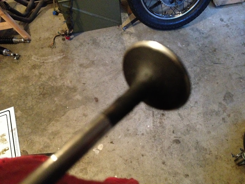

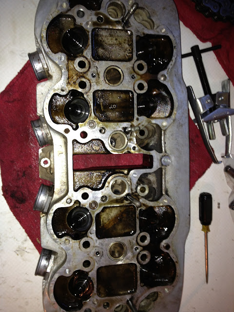

Next I worked on pulling all the valves.  I got a pretty cheap valve spring compressor from sears for $15, and for the most part it worked really well.  There was a little finesse involved in getting it lined up just right, but it wasn't bad.  Took me a little while to get a good method of popping the cotters out though.  But, eventually they were all out.
One part I was baffled on was the shop manual says to "remove and disassemble: cotter, retainer, valve spring (both), valve steam seal, spring seat, in that order".  Ok I got the first few pieces no problem, but how the heck do you get the stem seal and spring seat out?  I don't just want to dive in there and start digging, any tips?
All of the valves look about the same (sorry, fuzzy pic).  I don't see any real pitting or anything, but didn't examine them all that closely.
They look pretty good, is there any reason I shouldn't lap them?  I kinda figured since I was this far it might not be a bad idea?  Should I clean the rest of the valve up too?

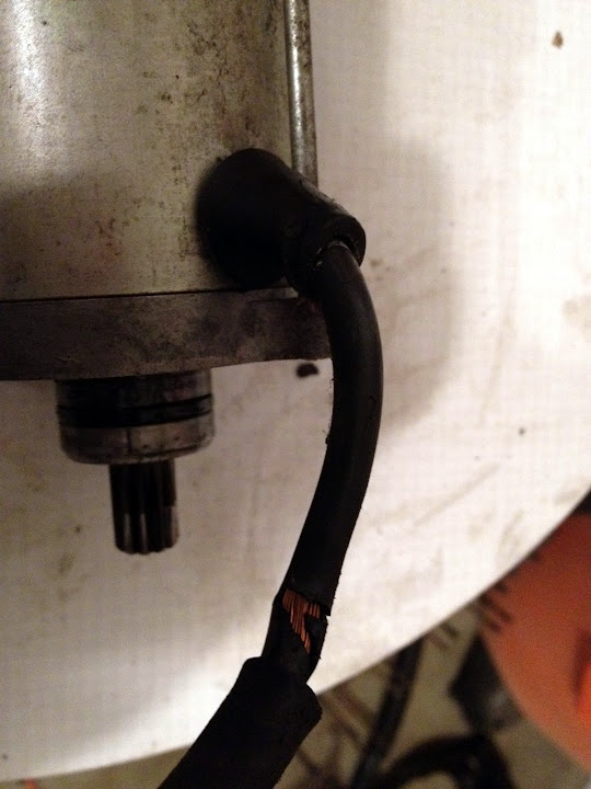

Lastly I pulled out the starter.  Another one of those times the shop manual just says something like "and lift it out", when really it takes a lot of wiggling and such to get it out.  I used the handle of my dead blow hammer to push a bit from the outside of the engine as I wiggled it up.  Took a little time, but I was trying to be careful.
Eventually it did come out.  Upon inspecting the wire, I noticed the old plastic wire wrap had cracked, and there was a good chunk of wire exposed.  The copper itself looks to be in fine condition (so I don't think it was cut or anything like that).  Will need to be sure to get some shrink tube around it before she goes back in though.
