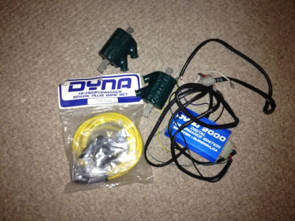

Oh, OK guys, I'm with you now. Hey Ken Cheers, the owner of the K1 I'm working on, bought a new Dyna 2000, coils and wires from a bike shop in the US for $380 bucks, plus shipping? I'd buy one myself, if I had a bike to put it in? Cheers, Terry. ;D
Sounds like it's time to find another 750 project Terry ;)
Terry - dont you have a project bike in Cali?
Ha ha, yeah mate, poor bloody Fred has been very good about it, I bought his K1 with title for only 200 bucks around July last year, plus I bought a heap of extra parts including some hard to find K0 stuff from EBay that I had delivered to his place. Trouble is, I can get the bike collected and moved to LA for shipping to Oz for pretty cheap, but the transport company won't take the boxes? No biggie though, it's not on the top of my priority list. Cheers, Terry. ;D

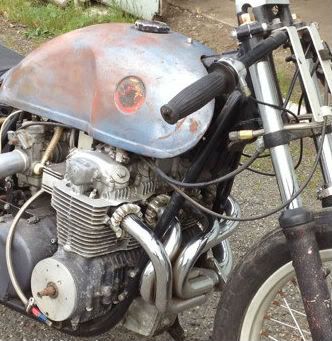

Got some ignition pieces in the post last week, and I pulled this bike out of the shed, and rolled it into the shop today.  Had a baby Black Widow on it, about 2mm big...thought to myself, You're gonna grow up, and I'm not gonna want to deal with you then...so I sent him packing on to some ancient VW.
Once I rolled the bike into the shop, we all gathered around and started trying to figure out the oil/gas/?alcohol?  :o :o Seriously no telling what the original builder had in mind...besides Bonneville.  I'll have to find a clever way to mount the coils if I want to keep the tank.  I'm starting to see why they were working toward a magneto set up as there's no room for coils in the stock spot..  If I could find one, I'd buy it, but while that search continues (any help fellas?) I'll use the Dyna 2000.  Still need the rotor, and the sender.  Dynoman quoted me ~150 for both, so I'll still have only spent >300 for the full Dyna set up.
We're pretty sure this black tank in the back is for oil water/alcohol, but not 100% on that.
The hose to NoWhere from the intake box is to a non existent boost gauge, you can see it between the fork and the frame down tubes.
Both fork seals are toast, but I didn't use the pair I bought for the 750, so I'll use those.

There was a guy I saw that ran the coils hidden inside a little diamond plate box he made that sat right under the carbs on top of the crankcase, then the 4 wires ran through the cylinder fins (I don't know how much of a good idea that was) and onto the plugs. Looked clean but it was a 750 and again not sure how long those wires will last.

Twisted, I think if I can fabricate a mount that lets me drop the coils about an inch from their stock mounting point I can make it work.  The bottom of the Benelli tank flares out from the frame tunnel...not flat like a Honda tank.
I've heard that good plug wires won't melt even if held against a hot exhaust pipe, but I wouldn't put 'em through that kinda heat.  I don't think I'd run 'em thru the cylinder cooling fins, but for all I know it'd be fine.

For years the Honda chopper builders have located their coils with the electrical box on top of the transmission, or on the down tube just behind the neck. Good wires and a good ground, and you can make it work.

Have you thought about the black tank being for a water/alcohol injection? Is pretty common on simple turbo set ups to prevent detonation on high boost.
That was definitely brought up as a possibility while we examined her in the shop this week...I've been looking for some installation info for the ATP kits (this is not a full ATP kit, but it'd be a starting point.)
