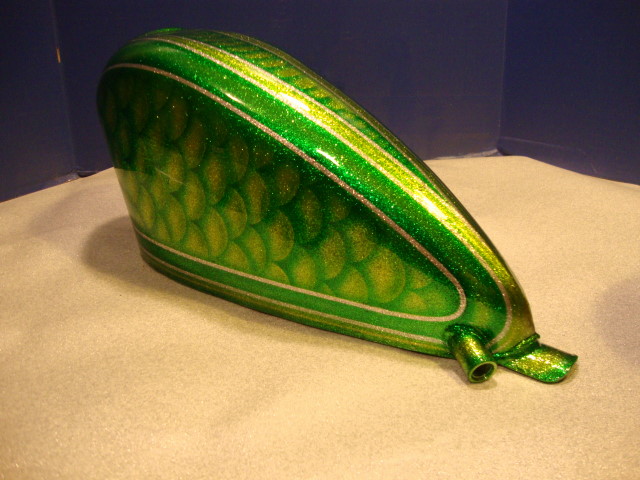

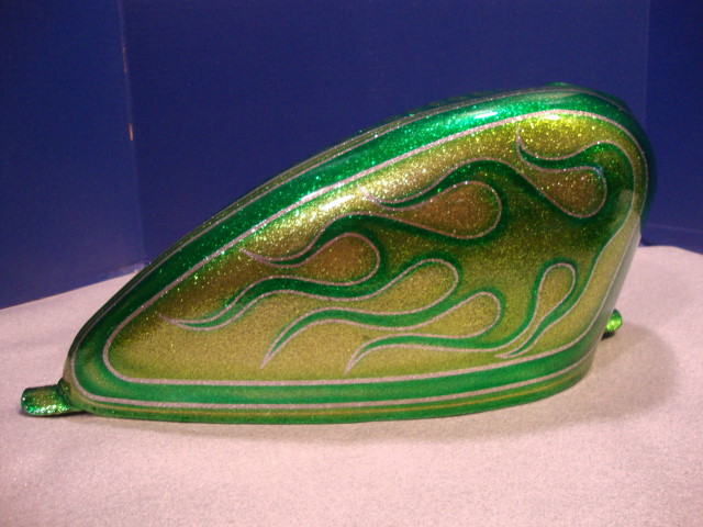

This sapphire blue above was applied with a silver flake base and a candy blue over it. You can tell because the flake is not visible in the areas that are in shadow. If it were just flake on top of the base coat then you would be able to see the flake at all times.
Dry flake is the method for shooting flake that is usually too big for guns, that real 1970's heavy flake look. Basically you lay down a wet clear coat and before it dries blow unsuspended flake onto the surface. Then you clear over it. You can use a compressor for it and there is a tool called the flake buster made specifically for it, but honestly I knew guys that would spray with one hand and throw flake at the part with the other like it was pixie dust.
here is a homemade setup using an air compressor:
poorman's flake buster
and the mini flake buster for flake with your airbrush:
Mini Flake Buster Tank Demo 1.wmv
The holo-flake you are using should look like this when done properly:
notice how you can see the base color underneath and the flake adds the color and punch?  It is it's own effect and some people really dig it, but it won't give you the effect you are looking for.
if you add a lot of flake to your paint (either in a mid coat or in suspension with the color coat - and BTW you should be shooting any kind of flake with a primer gun) you can you can end up with a finish that looks like this:
it is basically the technique you are using now but with lots of layers of buildup, notice how "thick" the finished paint looks? takes a mile of clear to make sure all your flake is laying flat and fully covered. sanding inbetween clear coats as well. The flake you are using right now isn't really good for this technique, plus this takes a metric ton of flake to do depending on the piece.
The effect you want is a candy over a premixed small silver flake paint. So your base is silver with flake premixed in and in suspension, and you do all your coloring with "candy" color tinited clears.
Showing you a piece with one color won't illustrate the effect very well so here are some examples of multi color designs over a solid consistent silver flake base:
notice how in eaxh of these examples it is the light filtering through the color that gives the flake the added depth and color appropriate sparkle?
