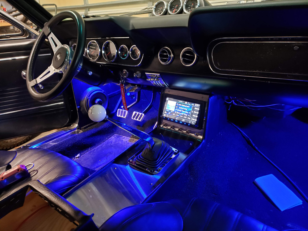

Speaking of the hardtop...its one of my daily drivers and i overbuilt the snot out of it because...why not?
It had a late model 302 that was ailing so i built up a 408w. Took the autotragic out and put a manual in (tko600). Fab9 rear with a 3link and coilovers. Coilovers up front. 17" wheels to fit over 13" brakes and LOTS of other things. Here are some pictures of that albatross around my neck

Great looking cars !  8)
I think I see a Griffin custom radiator ?
Nice to see them and the custom AC is necessary.
Do you like how your daily handles ?  :)

Thanks bud! The hardtop has a BeCool radiator that was made to fit the 71 big block cars. It's HUGE! I had to carve out the radiator opening 2" all the way around to really use it but it keeps that stroker cool even in 100+ degree heat with the AC on. The AC is kind of meh but it does enough to make it bearable in the real hot days. The headers bring heat in the car pretty bad still even with lots of floor insulation. I'm going to put some heat shielding around them in the near future.
The thing handles like its on rails. I live on a pretty twisty road that I can really rip it down if i want. I had it on a skid pad last year and managed to pull a little over 1g with summer performance tires that i'm currently not a fan of. I think i can get some more by switching to a softer compound. There is very little body roll compared to a stocker. I went to a 1 1/8" sway bar and grafted a convertible mustang substructure in stiffen up the unibody. Its a monstrous franken-car.
Here's a  dumb little video i did going down one of my roads. The angle is terrible and I'm hoping to do a better one when it cools off.
