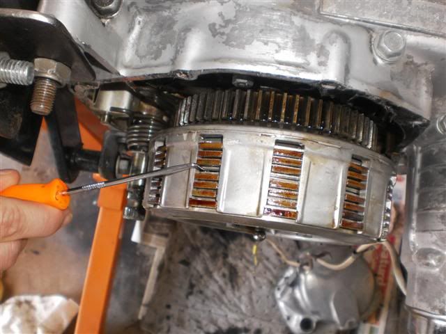

Woah woah woah. Hold the presses. Am i missing the double steel plate? this doesn't look right...
my plates don't look like the ones in this picture:
  • Posts: 17,245
Re: CB550 clutch not disengaging all the way
« Reply #15 on: November 29, 2012, 12:02:56 AM »
yours is an early clutch,,that twin steel disc was a later update,your engine number might be around 1117000?
