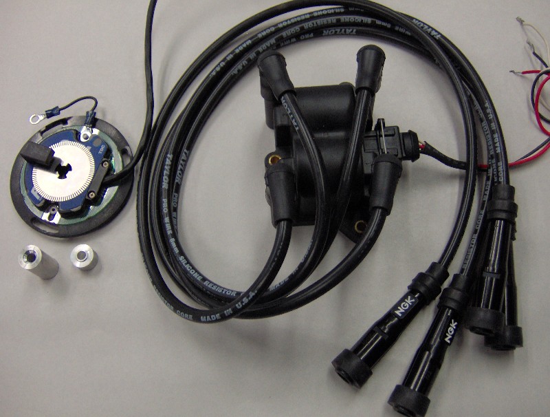

Now I'm working on a 71' CB750. Picked it up for 400 bucks, not running.
I got it running pretty quick, the ignition wiring was half assed at best. I ended up ordering a complete new optical ignition kit from cyclexchange. Eliminates the mechanical advance, excellent.

Love your bike!  Both of them.  My sister lives down in Brooklyn, so pretty down there.  Can you explain the optical ignition to a newb?
