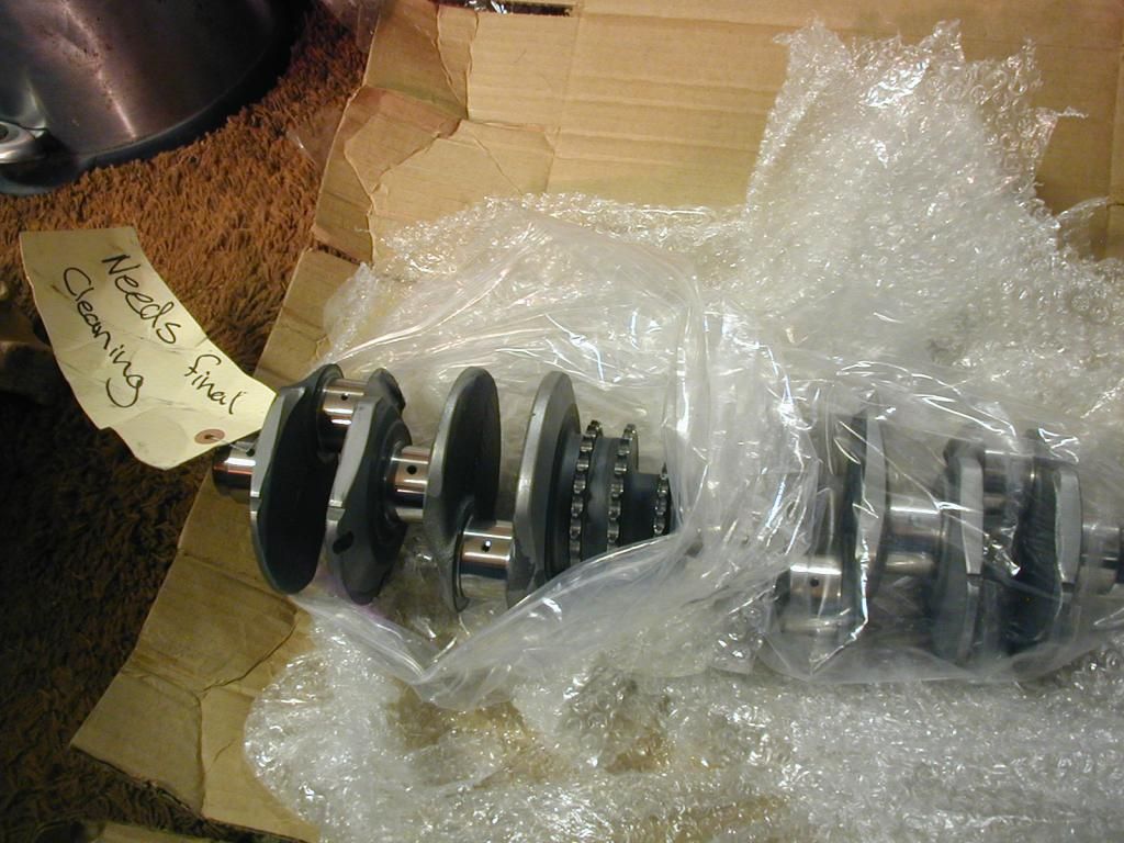

Well lookee here. What the cat(CycleX) left on the doorstep! Time for 900F crank to head out! Kenny,Thanks,Bill
another
This is what it should look like. ;D 8)
Cheers,
Brian
« Last Edit: October 02, 2013, 11:51:29 PM by bear »
  • Posts: 12,569
Re: A Bike Is Born....750/1000cc
« Reply #167 on: October 03, 2013, 05:45:39 AM »
Bear, What is that last crank? The primary chain gear is different.
Those rods are nice. Who makes them?
Offline bear
  • Posts: 2,577
  • Leeton in Australia
« Reply #168 on: October 03, 2013, 06:03:55 AM »
The crank is from a CB900F it uses Morse or Hy-vo cam and primary chains.
The rods are Falicon,
Cheers,
Brian

Offline Tintop
  • Posts: 3,970
« Reply #170 on: October 03, 2013, 09:02:29 AM »
Question Bear....will a DOHC CB750 crank fit the SOHC cases??  I'm limited to 900cc +5%, so that crank (with the HyVo chains), and a 915 kit would seem to be the way to go.  Alternative would be an 81 CB650 crank (HyVo chains), and Mikes billet barrel.  However that would give a very over square, short stroke engine (72.5 x 55.8).  Probably rev like crazy, but have weak low end torque.  Not so good for a sidecar.  Pm me so we don't hijack the thread.
