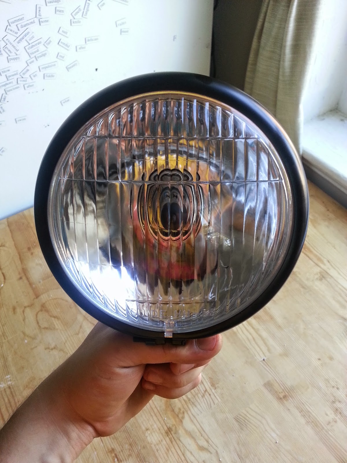

Hey, everyone. Got a few parts in yesterday and today. I'm going to relocate my ignition switch off of the trees and down on the right hand side under the gas tank. I bought this bracket to facilitate the move. I have Cycle X's key switch which has a 3rd sprung position so the bike starts like a car. I had this setup installed previously and it always worked great. I just decided I wanted to move it's location to clean up the "dash" area. I got done extending the wires to reach from the new position to the headlight bucket tonight.
I also got my new Hagon Shocks in from Dave Quinn. Awesome looking shocks and Dave is the man!
I decided that since I'm in the situation to go with a different headlight, I wanted to go with bottom mounted headlight in order to eliminate the headlight brackets on the forks.
I ordered this 6" headlight.
 I'm going to make up a bracket that will hold the front brake line splitter, the front turn signals and the headlight. It'll all bolt up to the lower fork clamp bolts. I need to get the headlight first before I figure it all out though.
Here it is naked!

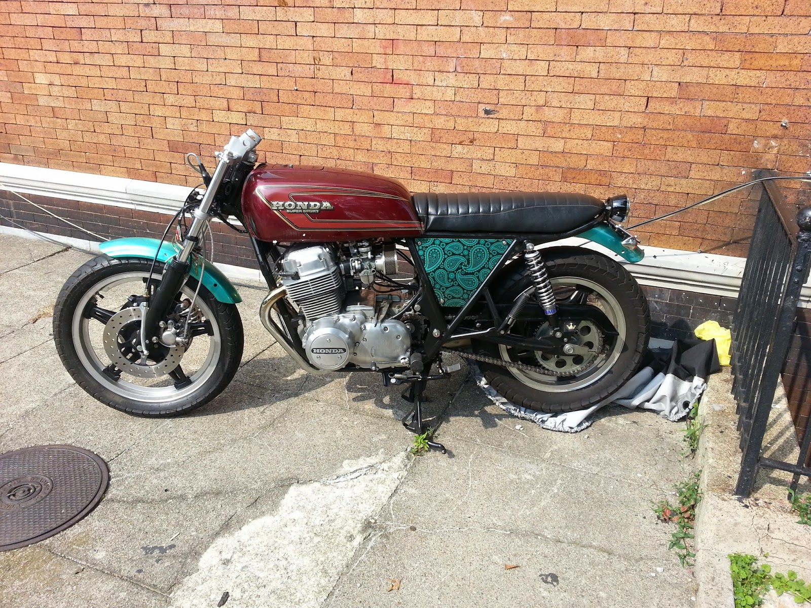

It's been a bit since I've posted any updates. I wanted to show the progress I've made over the last few weeks.
I picked up a new headlight and it's a little smaller than stock. I'm going for a little cleaner look up front. It's also a bottom mount headlight so I'm fabbing up a bracket for it this weekend so that it'll mount to the lower fork bolts.

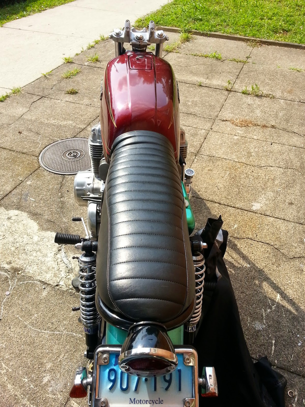

I've also gone back and forth about gas tanks. Do I like the K8 tank if I had another choice? Is there something better looking? I never gave it much thought before since the tank was clean and part of the bike. Since I now have the option and money to try something different, I decided to track down a 78 Supersport tank. I thought that the lines they have with my seat would make a really cool and unique combo.
I found a used, clean one after some extensive searching from the guys at Cycle X. I got it in and mounted it up. I ended up have to cut back my custom seat pan just a little bit so that it would lay under the rear of the tank and not wrinkle the seat covering.
These are the pictures before I did any cutting. I'll post some more once the tank gets back from the painter.
This past Tuesday I brought my wheels over to Working Class Cycles here in Philly to get my new Avon Road Riders mounted. While that was being done, I rigged up one of my cymbal stands to hold the front of the bike up so that I could change the fork seals. One of the seals I got from Cycle X were leaking so I decided to order some proper OEM ones. I made sure to smooth the seal surface and reinstalled the new seals with 15W fork oil. This should clear up that problem.
I also went back and forth with handlebars a little bit. I originally had some black superbike type bars on there, but once again, since I had the option to try something different, I tried Biltwell's tracker bars. I found them to be too low without enough pullback for my taste (Biltwell doesn't publish the rise or pullback specs) so I ended up selling those and picking up these Euro Style bars. They were really wide, so after cutting 3 3/8" off either side and getting my turn signal switch run though the bars, here they are mounted up.

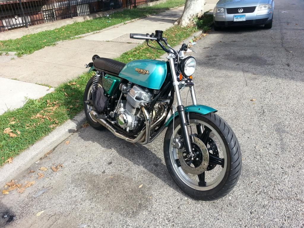

So I headed up to CT this past weekend to go to a party for me and my father's belated birthdays (I actually crashed this thing on my dad's birthday - July 28th) and had some time to fabricate a bracket for the headlight and front turn signals. I reused the little bracket I had made to hold the front brake splitter and fabbed up a piece for the headlight which I welded onto that. It's not the prettiest, but it's a whole lot of good enough. A couple quick coats of hammered silver paint and it was done. Took me a little bit of finessing with the upper brake line, but it actually worked out perfectly.
I also got out the gas bottle from my vacuum sync set and threw a quarter gallon of gas in it so that I could fire her up. Started right up which is a great thing and I sat on it and ran it through the gears since it was on the center stand. Now all I'm waiting for is for the gas tank to be finished with paint and I'm back on the road.

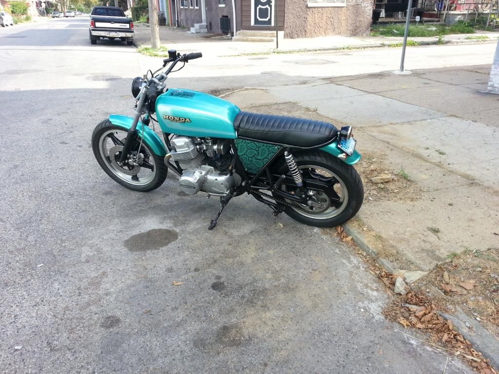

Got my gas tank back over the weekend and got it reinstalled. Went down and filled it up and spent the weekend riding. Feels so good to get back to this point. Thank you guys for all your support.

That's a cool side bag. How's that mounted?
Bike looks great after refreshments!
--Evan
1975 CB750K "Rhonda"
Offline Mr Freeze
  • Posts: 284
Re: So I got into a semi - bad accident with my 1978 CB750
« Reply #49 on: September 08, 2014, 07:39:44 AM »
That bag is one I got at an army surplus store. It has 4 straps that have snaps on them so I strapped it to the frame rail below the oil tank. Holds my tools and a 12v socket.
