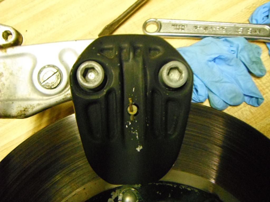

the clevis pin was attached to the pad, on my caliper it protrudes the the bake side and a cotter pin goes thru that hole
here is an old picture of it.
these are the best pictures that I have of it at the moment. what style are you talking about?
Tony

« Reply #3 on: August 08, 2014, 10:19:52 AM »
What model is your bike? I have a 550F and they don't have that style of pads.

« Reply #14 on: August 11, 2014, 01:22:34 PM »
You're most likely going to have to order to that corning's.  I found some on ebay, and a little goes a long way.  After I completely rebuilt my front brake (new MC, SS lines, new piston, seal, etc etc etc), it didn't squeak for a few months.  It rains a lot here and I ride year around.  Eventually it started squealing.  The faster I was going, the worse the squeal (when brake applied).  I tried everything without much luck.
I noticed that in your first pic you are holding two different types of brake pads.  The all black pads that you cut into don't have the 45 degree angle cut into the outside edges.  I eventually went back to the pads in the left side of your photo with the edges filed to 45 degrees (corning's on necessary parts, and brake quiet on the back of the pads), and I haven't heard a squeak/squeal all summer.
