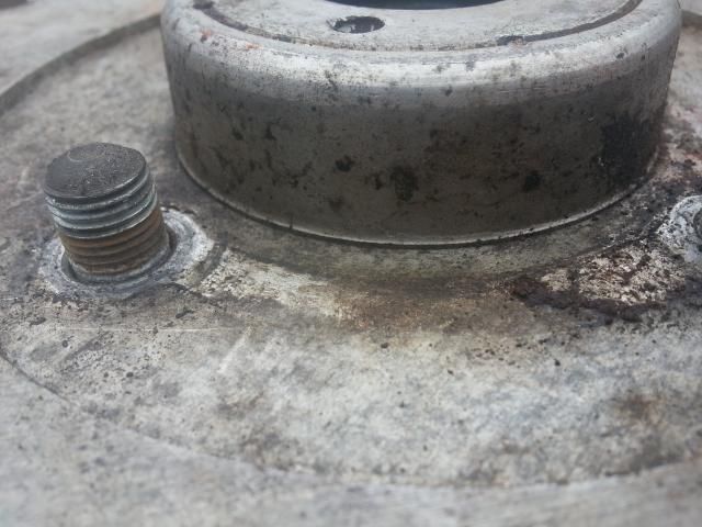

I'm in the process of coating customer parts off his 73 CB750. Even though I have years of mechanics experience I don't normally offer disassembly service when coating parts. In this case I made an exception as I figured it would be a piece of cake (I know better). Well I got as far as removing the sprocket nuts and lock washers. I looked at the fiche and it looks different than the one I have in hand. Sorry I don't have a pic right now. The fiche shows a sprocket plate after you remove the nuts and washers from the sprocket, mine doesn't have this plate. It looks as though the sprocket and flange that holds the bearing retainer are all one piece. The final drive flange should just separate from the hub but it is locked. How do I separate them without doing damage?
The "screw" that holds the speedo cable in the drive is buggered enough for me to not be able to tell if it is a phillips, torx, or allen. Which is it?

That is not a speedometer cable it is the bearing retainer.  It has 4 circles and should have punch marks between the bearing retainer and hub.  You need to very carefully drill out the peens with a small drill bit.
The speedmeter drive is on the front hub.

I'm sorry, that question was unrelated to the rear. There is a pin of some sort holding the plastic end of the speedo cable in the speedo drive. It's rusty and I can't tell if it's phillips, allen, or star.

It used to be JIS or Phillips.

I had a bad speedo phillips screw that was all buggered up. I took my Dremel and made a slot and used my impact driver to remove it.

This was accurate, as in used to be. How do I get this one out? Usual methods, heat it up, hit it with a hammer, hit it with a bigger hammer, Use an easy brake off on it?
