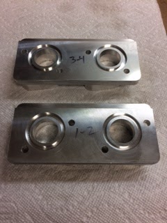

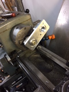

Cycle X straight intake manifolds on the lathe.  Made a fixture to hold the part so the O-ring groove could be cut.  Prefer to use the stock Honda O-ring.  Don't like the idea of using a sealer or gasket.
O-ring grooves cut and ready for matching to the intake ports.

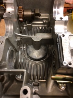

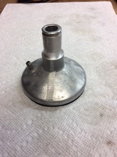

CB400 oil pickup post modification.  The neck has been "lengthened" by removing .250" material.  Note the shiny spot at the bottom of the neck.
CB400 oil pickup and CB650 oil pan installed.

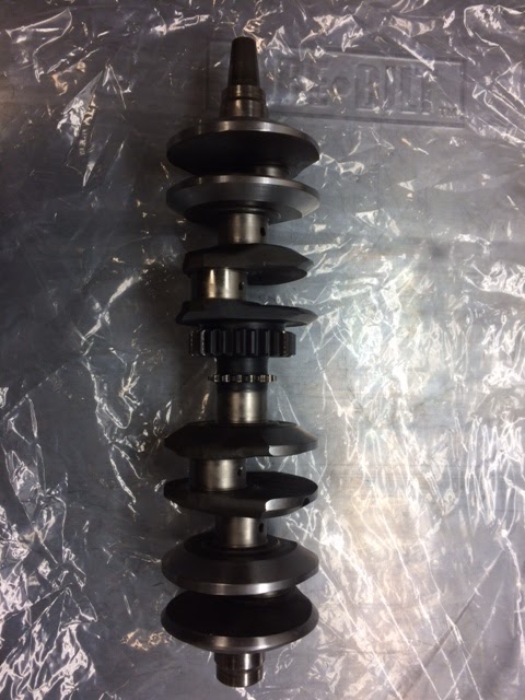

The last pieces to build my 2019 race motor have arrived!  Here are some lovely bits to drool over.  :D

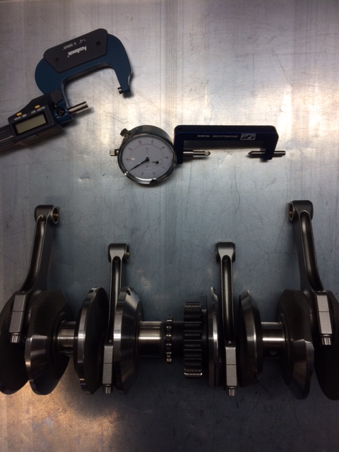

Balanced and lightened crank by APE.
Rods by Carrillo.
Assembled crank.  Went with the tool from Carrillo to measure the rod bolt stretch.

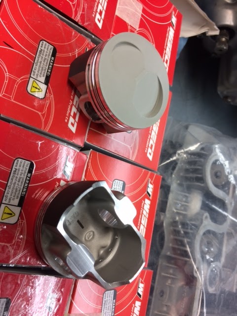

Wiseco pistons.  Thanks Brent.   ;)
The Wisecos come with the skirts already coated.  I had Swain Tech add their coating to the piston domes.  The bottom end is together, so next step is assembling the top end.  Can't wait to get it on the dyno and track to see what it will do!
