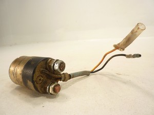

Been through some bad solenoids through the years.  but they always clicked at least. Continuity tested the two wires from the starter button by disconnecting the two wires at the solenoid . One lead on one wire one lead on the other. When I hit the start button it beeps on my meter (like it should) . I can bridge the posts and it starts like it should.
Scratching my head here.  If it is continuity testing good from where it leaves the solenoid to where it comes back (when I hit the button) then it should actuate the solenoid right?   I am not getting any voltage on either wire coming or going either.... is this just a bad solenoid?
Got another on the way brand new.  Just curious What you guys think. It is a 76 harness with a 78 motor cb750

Did you try jumpers directly from the battery to the solenoid?  Easiest way to check if the solenoid works.

Use two wires - one from the (+) and the otehr from the (-) on the battery and touch the solenoid low amp wires.
On the picture, these would be the two wires coming out of it, not the M6 posts.
Those two wires supply power to the electromagnet that makes the solenoid connect - aka click.

Well suprise suprise-
Solenoid works. I jumped the wires and it turned right over so guessing something with the switch perhaps. Just weird because when I continuity test from  one lead to the yellow /red and the other lead to the green/ red it does beep when I push the starter button Which would lead me believe the switch is fine. Any thoughts??
