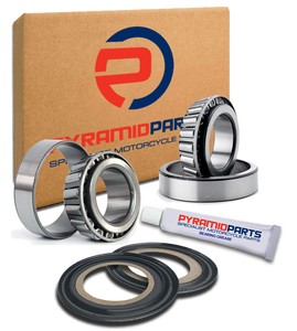

Offline scottly
  • Posts: 17,515
Re: Tapered Steering Bearings Thread
« Reply #569 on: July 14, 2016, 09:55:19 PM »
What does your seal look like? What about the upper seal? As far as I know, Honda never used an upper seal, and the aftermarket kit's upper seals create a problem?
Offline koendd
  • Posts: 343
« Reply #570 on: July 14, 2016, 11:13:15 PM »
this is the set I have..
didn't use the upperseal just jet. seems a perfect fit though, I still have to grind down the ridge on the inside of the  top collar as well

i just used the same kit on my CB500. Your order from the bottom up is correct.
I didn't use the top washer though, only the seal (there was no seal originally when Mr Honda made these so the seal could be optional as well).
The bottom bearing is a different size to the top so that's why they are different.
Can't tell you what the torque setting is sorry - I just tighten mine until there is no play and the steering is not overly tight when moved from side to side.
If you end up with too much space for the ears, you can grind the top nut although I simply added some o rings to the fork tubes to take up the extra space and they are hardly noticeable.
The main issue to watch for is that you end up with enough threaded area on the top of the stem to properly secure your top nut and washer.
