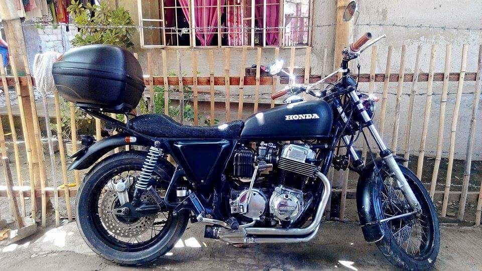

Here is my 1976 CB750F.

The muffs were just temporarily removed if you mean to say on my cb750f. I have a different plan on it. Perhaps going for 4-2 mufflers.

  I see your jugs on the engine are painted and detailed out a little. Good chance the engine has been out of the frame before. See if there are any signs of it ever being apart yet.
   One thing I always recommend in these situations where its been worked on etc. is to check the serial number of the engine just to make sure that it is indeed the year and model that you think it is and not a swap.

Already checked and identified already. Its ftom 1976 cb750f. Some of you might not recognized it basebon thr photo since the tank has been changed and the seats are changed as well as the side cover. But definitely the nos i have from the engine and the frame are matching those of the 1976 cb750f

It is but its got leakage already and the clutch is slipping as well. Its been opened before but was not removed from the frame. It was just to detail and clean it. It deserves to be rebuild after how many years its been running.
Sent from my SM-N9005 using Tapatalk
It HAS been removed from the frame if it was opened up. Exception: The ONLY way to take the top end off IN THE FRAME is if it's had a frame rail kit installed. Most of the time the engine comes out is due to internal damage or to do high performance work on it. If it's been worked up and it really doesn't need 'fixing' then you have a good chance of opening up a can of worms finding after market performance parts to 'fix' it.
