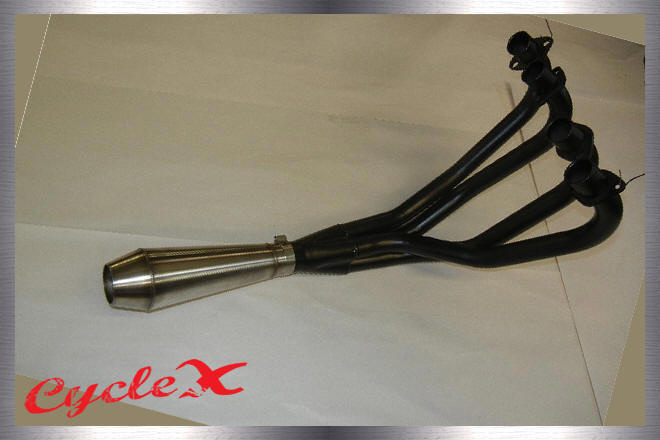

looks good! Congrats on being back on the road! also that's a nice looking exhaust, is it a Cycle-X?
Yeah, it's their Super 4 into 1. It has a super nice fit, real easy to hook up. Sounds sooooooo good, but super loud. Doesn't interfere with center stand usage, and you can leave it on for oil changes as there's room for the filter and room under the plug.
$379.00 Part number: EX-4into1-SUPER-BLK

« Reply #45 on: October 26, 2016, 03:29:21 PM »
The price is very good.  I assume that the tubes are high-temp painted mild steel.
